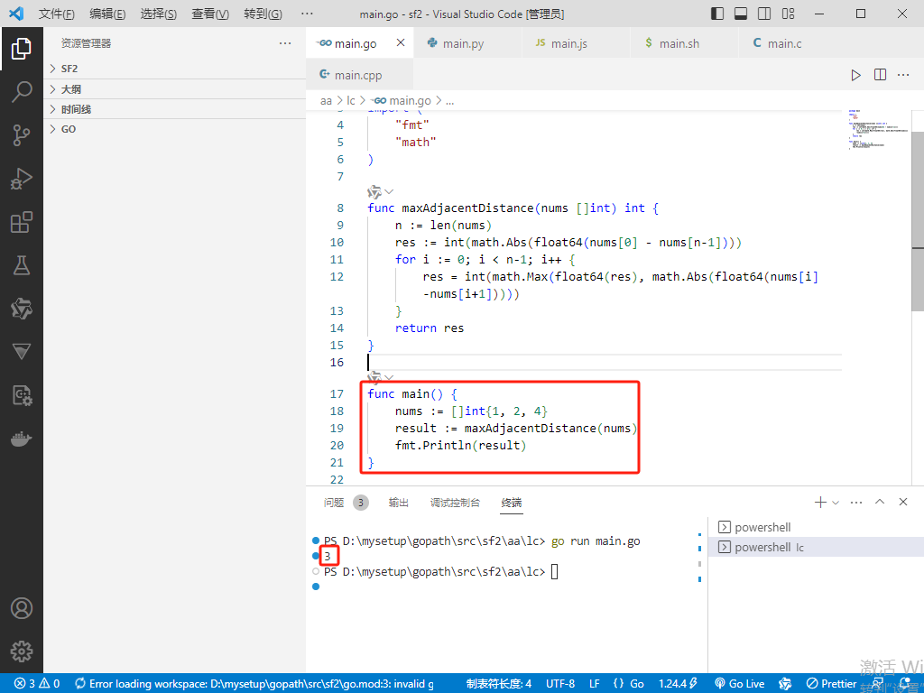

Go完整代码如下:
package main
import (
"fmt"
"math"
func maxAdjacentDistance(nums []int) int {
n := len(nums)
res := int(math.Abs(float64(nums[0] - nums[n-1])))
for i := 0; i < n-1; i++ {
res = int(math.Max(float64(res), math.Abs(float64(nums[i]-nums[i+1]))))
return res
func main() {
nums := []int{1, 2, 4}
result := maxAdjacentDistance(nums)
fmt.Println(result)

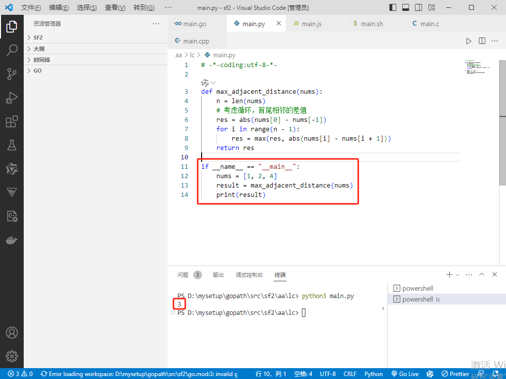

Python完整代码如下:
# -*-coding:utf-8-*-
def max_adjacent_distance(nums):
n = len(nums)
# 考虑循环,首尾相邻的差值
res = abs(nums[0] - nums[-1])
for i in range(n - 1):
res = max(res, abs(nums[i] - nums[i + 1]))
return res
if __name__ == "__main__":
nums = [1, 2, 4]
result = max_adjacent_distance(nums)
print(result)
