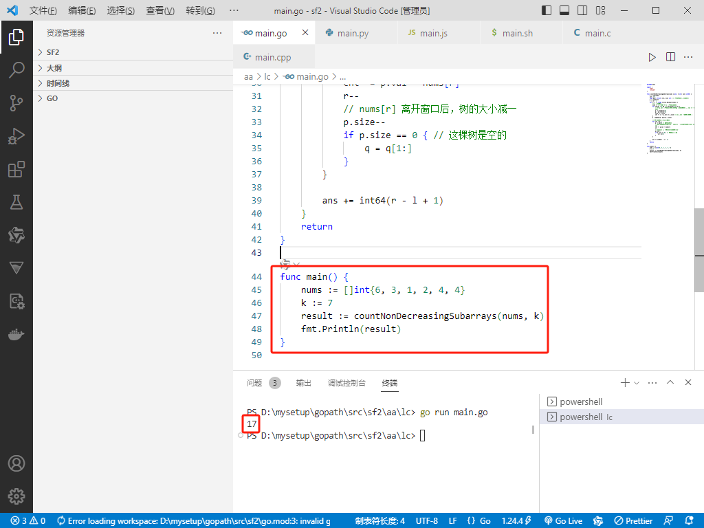

func main() {
nums := []int{6, 3, 1, 2, 4, 4}
k := 7
result := countNonDecreasingSubarrays(nums, k)
fmt.Println(result)

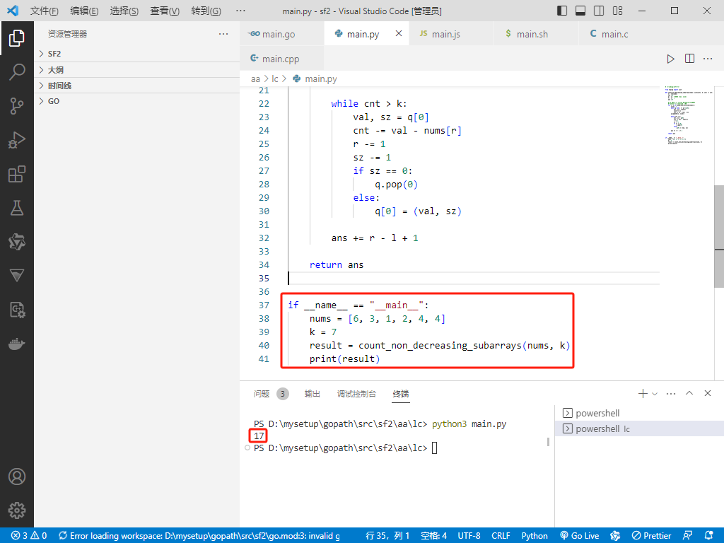

if __name__ == "__main__":
nums = [6, 3, 1, 2, 4, 4]
k = 7
result = count_non_decreasing_subarrays(nums, k)
print(result)
