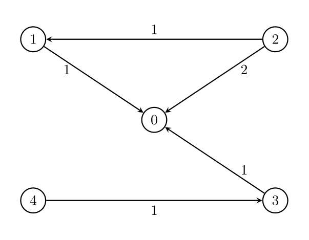

初始图:
  • 1 -> 0 (w=1)
  • 2 -> 0 (w=2)
  • 3 -> 0 (w=1)
  • 4 -> 3 (w=1)
  • 2 -> 1 (w=1)
目标是让所有节点(1, 2, 3, 4)都能到达 0,且每个节点的出边不超过 2,同时最大边权尽可能小。

示例的具体执行
反向图:
  • 0: [(1,1), (2,2), (3,1)]
  • 1: [(2,1)]
  • 3: [(4,1)]
  • 2: []
  • 4: []
Dijkstra 过程:
  1. 初始堆:[(0, 0)]dis = [0, ∞, ∞, ∞, ∞]
  2. 弹出 (0, 0),松弛邻边:
    • (1,1)dis[1] = max(0,1)=1,堆:[(1,1)]
    • (2,2)dis[2] = max(0,2)=2,堆:[(1,1), (2,2)]
    • (3,1)dis[3] = max(0,1)=1,堆:[(1,1), (1,3), (2,2)]
  3. 弹出 (1,1),松弛邻边 (2,1)
    • dis[2] = max(1,1)=1(比之前的 2 更优),堆:[(1,3), (1,2), (2,2)]
  4. 弹出 (1,3),松弛邻边 (4,1)
    • dis[4] = max(1,1)=1,堆:[(1,2), (1,4), (2,2)]
  5. 弹出 (1,2),无邻边。
  6. 弹出 (1,4),无邻边。
  7. 弹出 (2,2),无邻边。
最终 dis = [0, 1, 1, 1, 1],最大值为 1

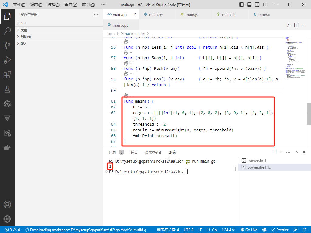

Go完整代码如下:
package main
import (
	"container/heap"
	"fmt"
	"math"
	"slices"
func minMaxWeight(n int, edges [][]int, _ int) int {
	if len(edges) < n-1 {
		return -1
	type edge struct{ to, w int }
	g := make([][]edge, n)
	for _, e := range edges {
		x, y, w := e[0], e[1], e[2]
		g[y] = append(g[y], edge{x, w})
	dis := make([]int, n)
	for i := range dis {
		dis[i] = math.MaxInt
	dis[0] = 0
	h := hp{{}}
	for len(h) > 0 {
		p := heap.Pop(&h).(pair)
		x := p.x
		d := p.dis
		if d > dis[x] {
			continue
		for _, e := range g[x] {
			y := e.to
			newD := max(d, e.w)
			if newD < dis[y] {
				dis[y] = newD
				heap.Push(&h, pair{newD, y})
	ans := slices.Max(dis)
	if ans == math.MaxInt {
		return -1
	return ans
type pair struct{ dis, x int } // 路径最大边权, 节点编号
type hp []pair
func (h hp) Len() int           { return len(h) }
func (h hp) Less(i, j int) bool { return h[i].dis < h[j].dis }
func (h hp) Swap(i, j int)      { h[i], h[j] = h[j], h[i] }
func (h *hp) Push(v any)        { *h = append(*h, v.(pair)) }
func (h *hp) Pop() (v any)      { a := *h; *h, v = a[:len(a)-1], a[len(a)-1]; return }
func main() {
	n := 5
	edges := [][]int{{1, 0, 1}, {2, 0, 2}, {3, 0, 1}, {4, 3, 1}, {2, 1, 1}}
	threshold := 2
	result := minMaxWeight(n, edges, threshold)
	fmt.Println(result)

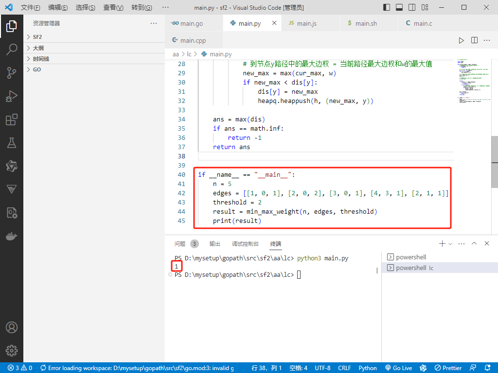

Python完整代码如下:
# -*-coding:utf-8-*-
import heapq
import math
def min_max_weight(n, edges, threshold):
    # 边数量不足以连接所有节点,直接返回 -1
    if len(edges) < n - 1:
        return -1
    # 建立反向图:因为要求所有节点能到达0,方便从0开始跑反向边
    g = [[] for _ in range(n)]
    for x, y, w in edges:
        g[y].append((x, w))
    # 距离数组,dis[i]表示从节点0到i路径上边权最大值的最小可能值
    dis = [math.inf] * n
    dis[0] = 0
    # 优先队列,存放(pair(当前路径最大边权,节点))
    h = [(0, 0)]
    while h:
        cur_max, x = heapq.heappop(h)
        if cur_max > dis[x]:
            continue
        for y, w in g[x]:
            # 到节点y路径中的最大边权 = 当前路径最大边权和w的最大值
            new_max = max(cur_max, w)
            if new_max < dis[y]:
                dis[y] = new_max
                heapq.heappush(h, (new_max, y))
    ans = max(dis)
    if ans == math.inf:
        return -1
    return ans
if __name__ == "__main__":
    n = 5
    edges = [[1, 0, 1], [2, 0, 2], [3, 0, 1], [4, 3, 1], [2, 1, 1]]
    threshold = 2
    result = min_max_weight(n, edges, threshold)
    print(result)
