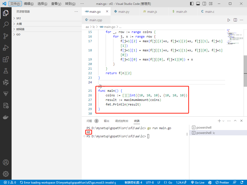

Go完整代码如下:
package main
import (
	"fmt"
	"math"
func maximumAmount(coins [][]int) int {
	n := len(coins[0])
	f := make([][3]int, n+1)
	for j := range f {
		f[j] = [3]int{math.MinInt / 2, math.MinInt / 2, math.MinInt / 2}
	f[1] = [3]int{}
	for _, row := range coins {
		for j, x := range row {
			f[j+1][2] = max(f[j][2]+x, f[j+1][2]+x, f[j][1], f[j+1][1])
			f[j+1][1] = max(f[j][1]+x, f[j+1][1]+x, f[j][0], f[j+1][0])
			f[j+1][0] = max(f[j][0], f[j+1][0]) + x
	return f[n][2]
func main() {
	coins := [][]int{{10, 10, 10}, {10, 10, 10}}
	result := maximumAmount(coins)
	fmt.Println(result)

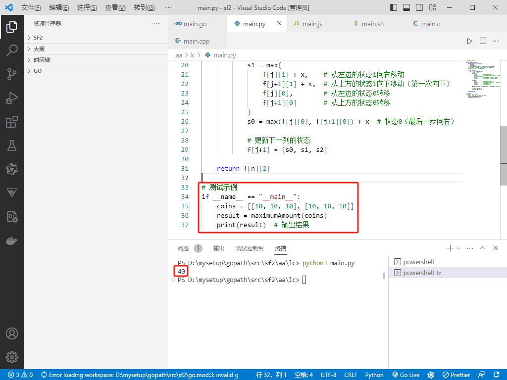

Python完整代码如下:
# -*-coding:utf-8-*-
def maximumAmount(coins):
    if not coins or not coins[0]:
        return 0
    n = len(coins[0])
    # 初始化dp数组,f[j]表示到第j列(0-indexed)的三种状态
    f = [[-10**18, -10**18, -10**18] for _ in range(n+1)]
    f[1] = [0, 0, 0]  # 起始点初始化
    for row in coins:
        for j, x in enumerate(row):
            # 状态转移方程
            s2 = max(
                f[j][2] + x,    # 从左边的状态2向右移动
                f[j+1][2] + x,  # 从上方的状态2向下移动(连续第三次向下,但按状态2处理)
                f[j][1],        # 从左边的状态1转移(不连续向下)
                f[j+1][1]       # 从上方的状态1转移(不连续向下)
            s1 = max(
                f[j][1] + x,    # 从左边的状态1向右移动
                f[j+1][1] + x,  # 从上方的状态1向下移动(第一次向下)
                f[j][0],        # 从左边的状态0转移
                f[j+1][0]       # 从上方的状态0转移
            s0 = max(f[j][0], f[j+1][0]) + x  # 状态0(最后一步向右)
            # 更新下一列的状态
            f[j+1] = [s0, s1, s2]
    return f[n][2]
# 测试示例
if __name__ == "__main__":
    coins = [[10, 10, 10], [10, 10, 10]]
    result = maximumAmount(coins)
    print(result)  # 输出结果
