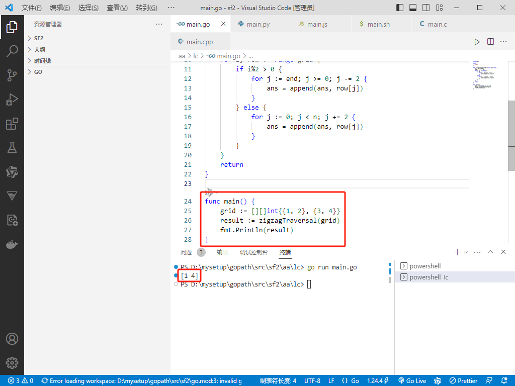

Go完整代码如下:
package main
import (
	"fmt"
func zigzagTraversal(grid [][]int) (ans []int) {
	n := len(grid[0])
	end := n - 1 - n%2
	for i, row := range grid {
		if i%2 > 0 {
			for j := end; j >= 0; j -= 2 {
				ans = append(ans, row[j])
		} else {
			for j := 0; j < n; j += 2 {
	return
func main() {
	grid := [][]int{{1, 2}, {3, 4}}
	result := zigzagTraversal(grid)
	fmt.Println(result)

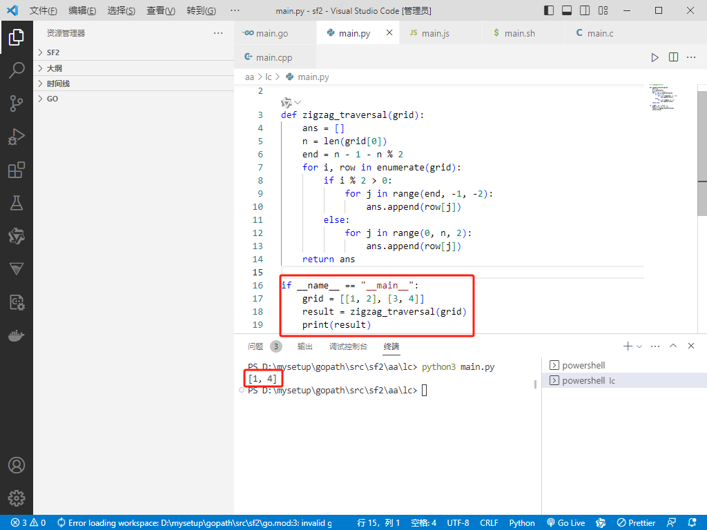

Python完整代码如下:
# -*-coding:utf-8-*-
def zigzag_traversal(grid):
    ans = []
    n = len(grid[0])
    end = n - 1 - n % 2
    for i, row in enumerate(grid):
        if i % 2 > 0:
            for j in range(end, -1, -2):
                ans.append(row[j])
        else:
            for j in range(0, n, 2):
                ans.append(row[j])
    return ans
if __name__ == "__main__":
    grid = [[1, 2], [3, 4]]
    result = zigzag_traversal(grid)
    print(result)
