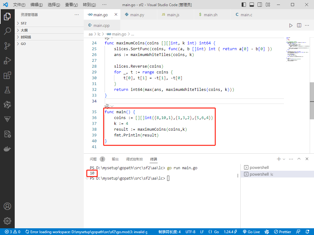

Go完整代码如下:
package main
import (
	"fmt"
	"slices"
// 2271. 毯子覆盖的最多白色砖块数
func maximumWhiteTiles(tiles [][]int, carpetLen int) (ans int) {
	cover, left := 0, 0
	for _, tile := range tiles {
		tl, tr, c := tile[0], tile[1], tile[2]
		cover += (tr - tl + 1) * c
		for tiles[left][1]+carpetLen-1 < tr {
			cover -= (tiles[left][1] - tiles[left][0] + 1) * tiles[left][2]
			left++
		uncover := max((tr-carpetLen+1-tiles[left][0])*tiles[left][2], 0)
		ans = max(ans, cover-uncover)
	return
func maximumCoins(coins [][]int, k int) int64 {
	slices.SortFunc(coins, func(a, b []int) int { return a[0] - b[0] })
	ans := maximumWhiteTiles(coins, k)
	slices.Reverse(coins)
	for _, t := range coins {
		t[0], t[1] = -t[1], -t[0]
	return int64(max(ans, maximumWhiteTiles(coins, k)))
func main() {
	coins := [][]int{{8,10,1},{1,3,2},{5,6,4}}
	k := 4
	result := maximumCoins(coins,k)
	fmt.Println(result)

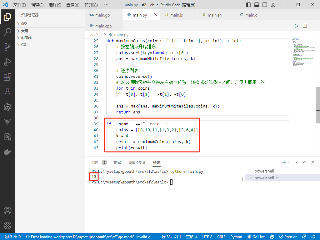

Python完整代码如下:
# -*-coding:utf-8-*-
from typing import List
def maximumWhiteTiles(tiles: List[List[int]], carpetLen: int) -> int:
    ans = 0
    cover = 0
    left = 0
    for right in range(len(tiles)):
        tl, tr, c = tiles[right]
        # 当区间无法被地毯覆盖时,移动左指针缩小覆盖区间
        while tiles[left][1] + carpetLen - 1 < tr:
            left += 1
        # 计算未覆盖部分的硬币数
        uncover = max((tr - carpetLen + 1 - tiles[left][0]) * tiles[left][2], 0)
        ans = max(ans, cover - uncover)
    return ans
def maximumCoins(coins: List[List[int]], k: int) -> int:
    # 按左端点升序排序
    coins.sort(key=lambda x: x[0])
    ans = maximumWhiteTiles(coins, k)
    # 逆序列表
    coins.reverse()
    # 对区间取负数并交换左右端点位置,转换成类似负轴区间,方便再调用一次
    for t in coins:
    ans = max(ans, maximumWhiteTiles(coins, k))
    return ans
if __name__ == "__main__":
    coins = [[8,10,1],[1,3,2],[5,6,4]]
    k = 4
    result = maximumCoins(coins, k)
    print(result)
