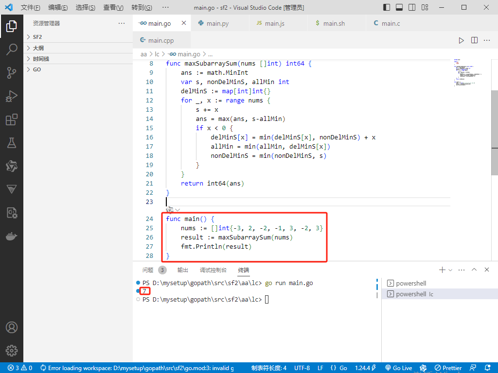

package main
import (
	"fmt"
	"math"
func maxSubarraySum(nums []int) int64 {
	ans := math.MinInt
	var s, nonDelMinS, allMin int
	delMinS := map[int]int{}
	for _, x := range nums {
		s += x
		ans = max(ans, s-allMin)
		if x < 0 {
			delMinS[x] = min(delMinS[x], nonDelMinS) + x
			allMin = min(allMin, delMinS[x])
			nonDelMinS = min(nonDelMinS, s)
	return int64(ans)
func main() {
	nums := []int{-3, 2, -2, -1, 3, -2, 3}
	result := maxSubarraySum(nums)
	fmt.Println(result)

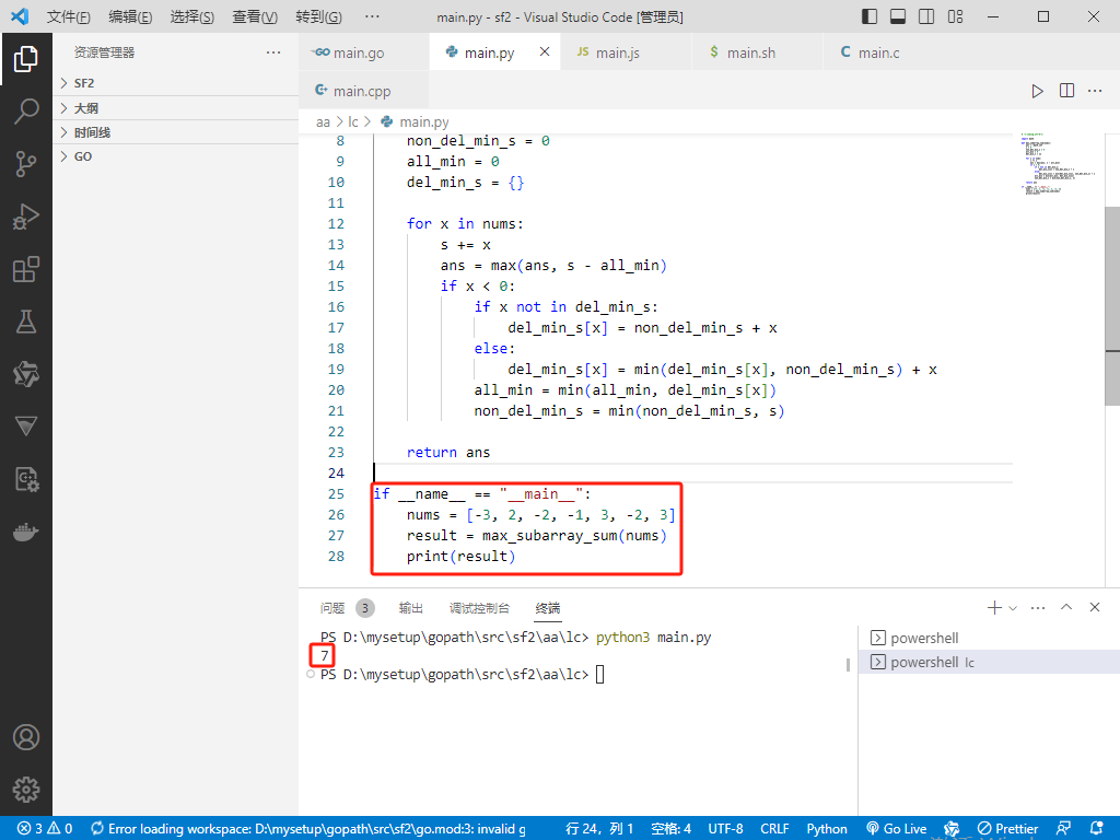

Python完整代码如下:
# -*-coding:utf-8-*-
import math
def max_subarray_sum(nums):
    ans = -math.inf
    s = 0
    non_del_min_s = 0
    all_min = 0
    del_min_s = {}
    for x in nums:
        s += x
        ans = max(ans, s - all_min)
        if x < 0:
            if x not in del_min_s:
                del_min_s[x] = non_del_min_s + x
            else:
                del_min_s[x] = min(del_min_s[x], non_del_min_s) + x
            all_min = min(all_min, del_min_s[x])
            non_del_min_s = min(non_del_min_s, s)
    return ans
if __name__ == "__main__":
    nums = [-3, 2, -2, -1, 3, -2, 3]
    result = max_subarray_sum(nums)
    print(result)
