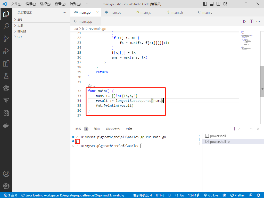

Go完整代码如下:
package main
import (
"fmt"
"slices"
func longestSubsequence(nums []int) (ans int) {
mx := slices.Max(nums)
maxD := mx - slices.Min(nums)
f := make([][]int, mx+1)
for i := range f {
f[i] = make([]int, maxD+1)
for _, x := range nums {
fx := 1
for j := maxD; j >= 0; j-- {
if x-j >= 0 {
fx = max(fx, f[x-j][j]+1)
if x+j <= mx {
fx = max(fx, f[x+j][j]+1)
f[x][j] = fx
ans = max(ans, fx)
return
func main() {
nums := []int{16,6,3}
result := longestSubsequence(nums)
fmt.Println(result)

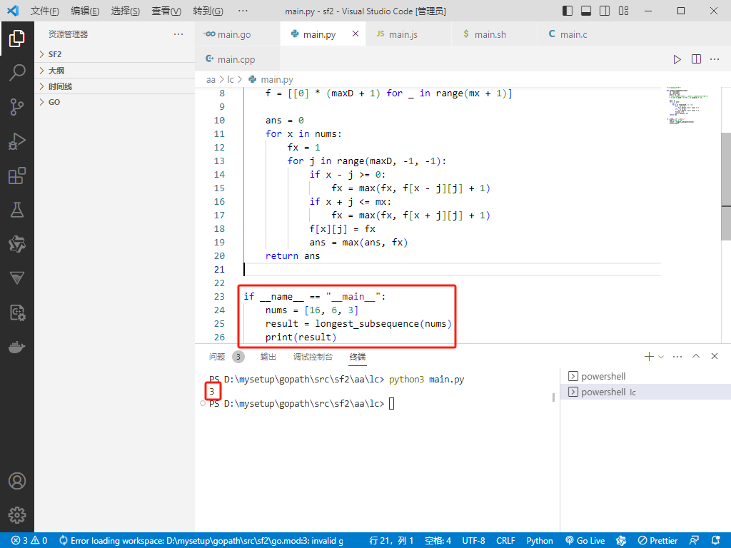

Python完整代码如下:
# -*-coding:utf-8-*-
def longest_subsequence(nums):
mx = max(nums)
mn = min(nums)
maxD = mx - mn
# 创建二维数组 f,大小为 (mx+1) x (maxD+1),初始化为0
f = [[0] * (maxD + 1) for _ in range(mx + 1)]
ans = 0
for x in nums:
fx = 1
for j in range(maxD, -1, -1):
if x - j >= 0:
fx = max(fx, f[x - j][j] + 1)
if x + j <= mx:
fx = max(fx, f[x + j][j] + 1)
f[x][j] = fx
ans = max(ans, fx)
return ans
if __name__ == "__main__":
nums = [16, 6, 3]
result = longest_subsequence(nums)
print(result)
