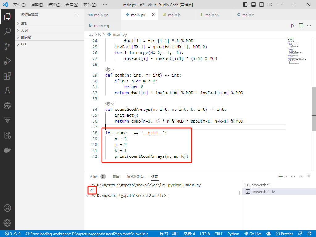

Python完整代码如下:
# -*-coding:utf-8-*-
MOD = 10**9 + 7
MX = 100000
fact = [0] * MX
invFact = [0] * MX
def qpow(x: int, n: int) -> int:
    res = 1
    base = x % MOD
    while n > 0:
        if n & 1:
            res = res * base % MOD
        base = base * base % MOD
        n >>= 1
    return res
def initFact():
    if fact[0] != 0:
        return
    fact[0] = 1
    for i in range(1, MX):
        fact[i] = fact[i-1] * i % MOD
    invFact[MX-1] = qpow(fact[MX-1], MOD-2)
    for i in range(MX-2, -1, -1):
        invFact[i] = invFact[i+1] * (i+1) % MOD
def comb(n: int, m: int) -> int:
    if m > n or m < 0:
        return 0
    return fact[n] * invFact[m] % MOD * invFact[n-m] % MOD
def countGoodArrays(n: int, m: int, k: int) -> int:
    initFact()
    return comb(n-1, k) * m % MOD * qpow(m-1, n-k-1) % MOD
if __name__ == '__main__':
    n = 3
    m = 2
    k = 1
    print(countGoodArrays(n, m, k))
