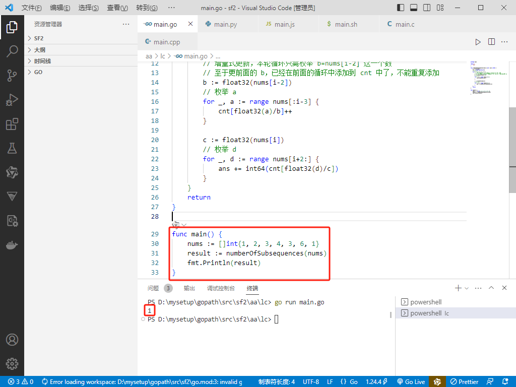

Go完整代码如下:
package main
import (
	"fmt"
func numberOfSubsequences(nums []int) (ans int64) {
	n := len(nums)
	cnt := map[float32]int{}
	// 枚举 b 和 c
	for i := 4; i < n-2; i++ {
		// 增量式更新,本轮循环只需枚举 b=nums[i-2] 这一个数
		// 至于更前面的 b,已经在前面的循环中添加到 cnt 中了,不能重复添加
		b := float32(nums[i-2])
		// 枚举 a
		for _, a := range nums[:i-3] {
			cnt[float32(a)/b]++
		c := float32(nums[i])
		// 枚举 d
		for _, d := range nums[i+2:] {
			ans += int64(cnt[float32(d)/c])
	return
func main() {
	nums := []int{1, 2, 3, 4, 3, 6, 1}
	result := numberOfSubsequences(nums)
	fmt.Println(result)

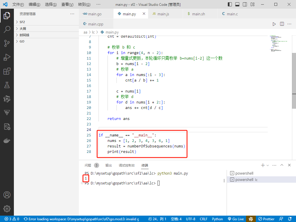

Python完整代码如下:
# -*-coding:utf-8-*-
def numberOfSubsequences(nums):
    from collections import defaultdict
    ans = 0
    n = len(nums)
    cnt = defaultdict(int)
    # 枚举 b 和 c
    for i in range(4, n - 2):
        # 增量式更新,本轮循环只需枚举 b=nums[i-2] 这一个数
        b = nums[i - 2]
        # 枚举 a
        for a in nums[:i - 3]:
            cnt[a / b] += 1
        c = nums[i]
        # 枚举 d
        for d in nums[i + 2:]:
            ans += cnt[d / c]
    return ans
if __name__ == "__main__":
    nums = [1, 2, 3, 4, 3, 6, 1]
    result = numberOfSubsequences(nums)
    print(result)
