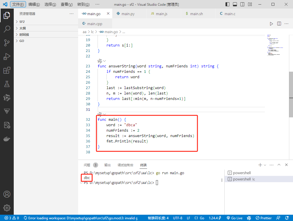

Go完整代码如下:
package main
import (
"fmt"
func lastSubstring(s string) string {
i, j, n := 0, 1, len(s)
for j < n {
k := 0
for j+k < n && s[i+k] == s[j+k] {
k++
if j+k < n && s[i+k] < s[j+k] {
i, j = j, max(j+1, i+k+1)
} else {
j = j + k + 1
return s[i:]
func answerString(word string, numFriends int) string {
if numFriends == 1 {
return word
last := lastSubstring(word)
n, m := len(word), len(last)
return last[:min(m, n-numFriends+1)]
func main() {
word := "dbca"
numFriends := 2
result := answerString(word, numFriends)
fmt.Println(result)

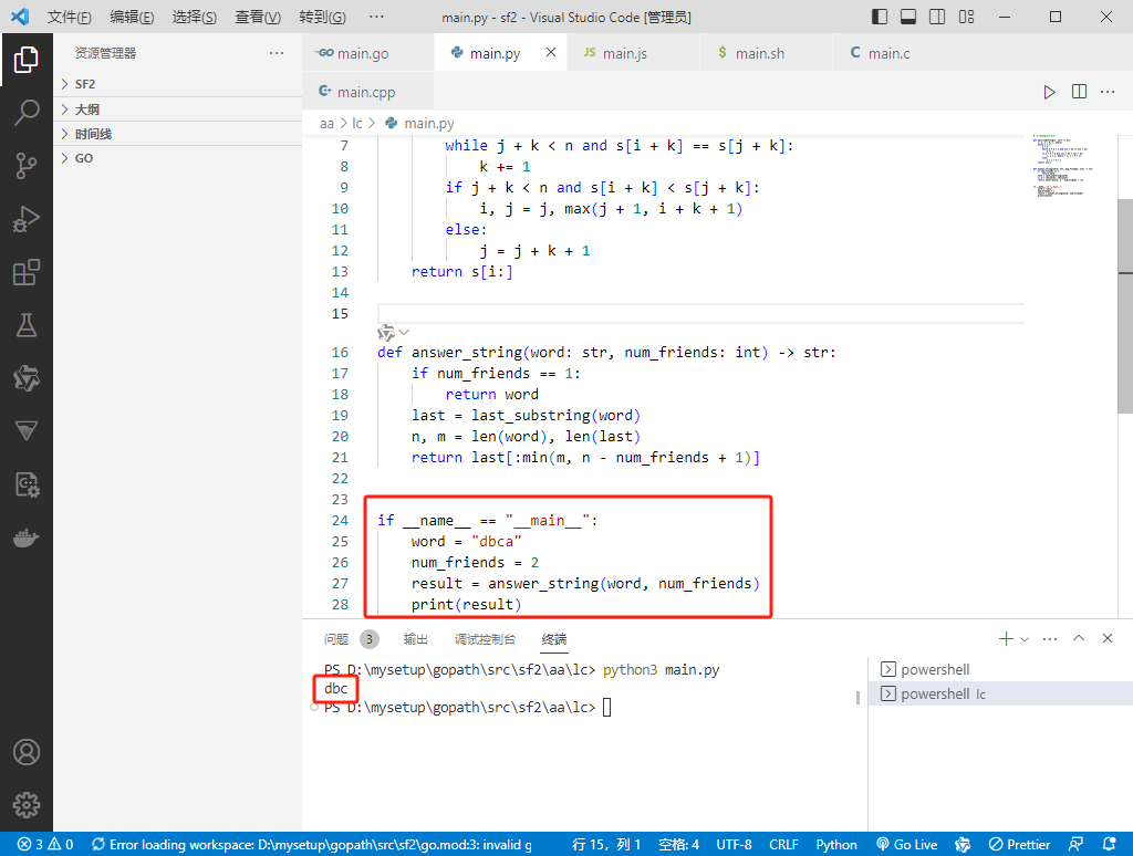

Python完整代码如下:
# -*-coding:utf-8-*-
def last_substring(s: str) -> str:
i, j, n = 0, 1, len(s)
while j < n:
k = 0
while j + k < n and s[i + k] == s[j + k]:
k += 1
if j + k < n and s[i + k] < s[j + k]:
i, j = j, max(j + 1, i + k + 1)
else:
j = j + k + 1
return s[i:]
def answer_string(word: str, num_friends: int) -> str:
if num_friends == 1:
return word
last = last_substring(word)
n, m = len(word), len(last)
return last[:min(m, n - num_friends + 1)]
if __name__ == "__main__":
word = "dbca"
num_friends = 2
result = answer_string(word, num_friends)
print(result)
