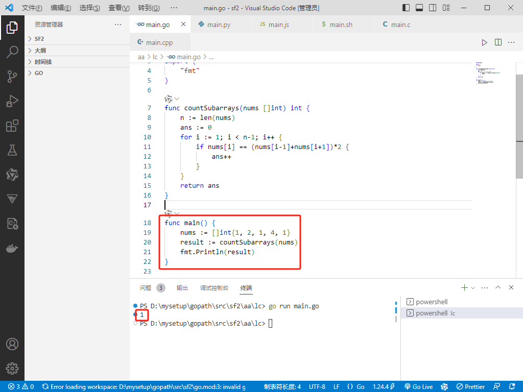

Go完整代码如下:
package main
import (
	"fmt"
func countSubarrays(nums []int) int {
	n := len(nums)
	ans := 0
	for i := 1; i < n-1; i++ {
		if nums[i] == (nums[i-1]+nums[i+1])*2 {
			ans++
	return ans
func main() {
	nums := []int{1, 2, 1, 4, 1}
	result := countSubarrays(nums)
	fmt.Println(result)

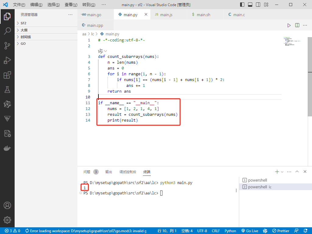

Python完整代码如下:
# -*-coding:utf-8-*-
def count_subarrays(nums):
    n = len(nums)
    ans = 0
    for i in range(1, n - 1):
        if nums[i] == (nums[i - 1] + nums[i + 1]) * 2:
            ans += 1
    return ans
if __name__ == "__main__":
    nums = [1, 2, 1, 4, 1]
    result = count_subarrays(nums)
    print(result)
