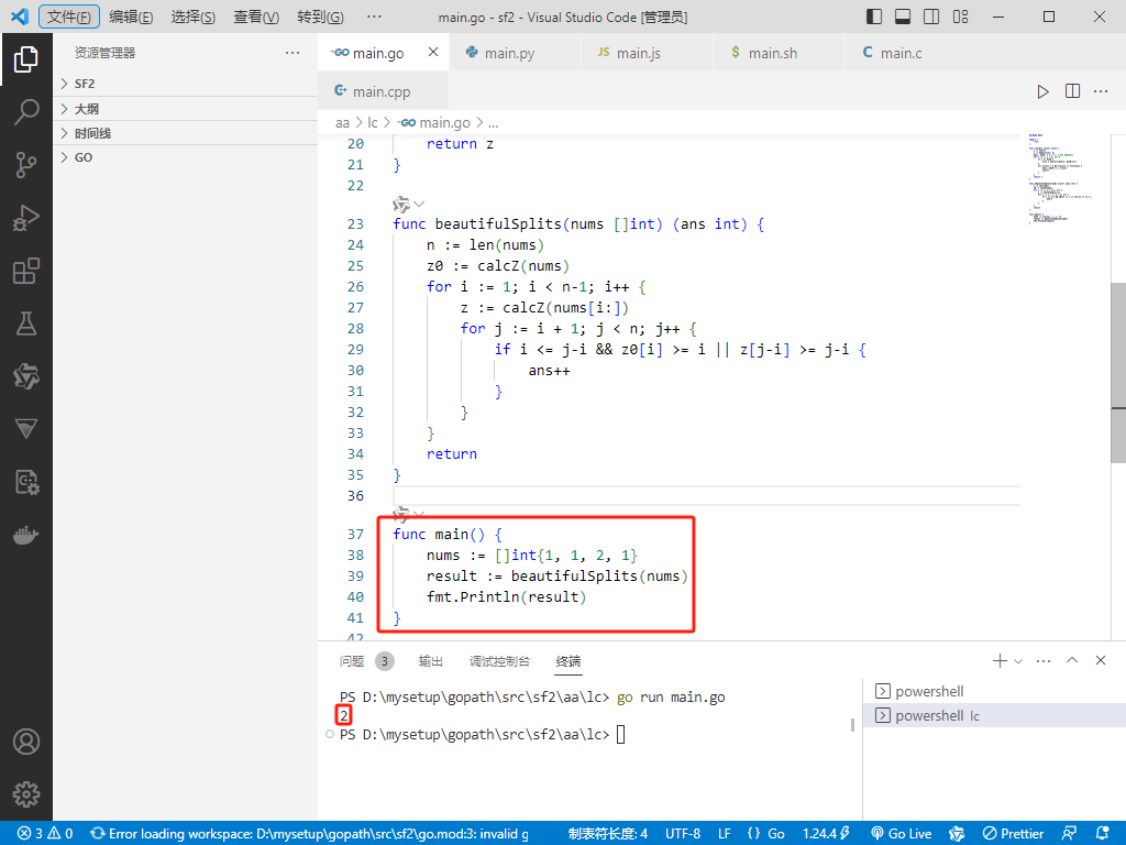

Go完整代码如下:
package main
import (
	"fmt"
func calcZ(s []int) []int {
	n := len(s)
	z := make([]int, n)
	boxL, boxR := 0, 0 // z-box 左右边界
	for i := 1; i < n; i++ {
		if i <= boxR {
			z[i] = min(z[i-boxL], boxR-i+1)
		for i+z[i] < n && s[z[i]] == s[i+z[i]] {
			boxL, boxR = i, i+z[i]
			z[i]++
	return z
func beautifulSplits(nums []int) (ans int) {
	n := len(nums)
	z0 := calcZ(nums)
	for i := 1; i < n-1; i++ {
		z := calcZ(nums[i:])
		for j := i + 1; j < n; j++ {
			if i <= j-i && z0[i] >= i || z[j-i] >= j-i {
				ans++
	return
func main() {
	nums := []int{1, 1, 2, 1}
	result := beautifulSplits(nums)
	fmt.Println(result)

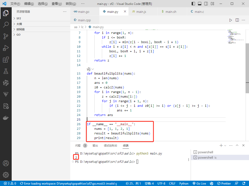

Python完整代码如下:
# -*-coding:utf-8-*-
def calcZ(s):
    n = len(s)
    z = [0] * n
    boxL, boxR = 0, 0  # Z-box 左右边界
    for i in range(1, n):
        if i <= boxR:
            z[i] = min(z[i - boxL], boxR - i + 1)
        while i + z[i] < n and s[z[i]] == s[i + z[i]]:
            boxL, boxR = i, i + z[i]
            z[i] += 1
    return z
def beautifulSplits(nums):
    n = len(nums)
    ans = 0
    z0 = calcZ(nums)
    for i in range(1, n - 1):
        z = calcZ(nums[i:])
        for j in range(i + 1, n):
            if (i <= j - i and z0[i] >= i) or (z[j - i] >= j - i):
                ans += 1
    return ans
if __name__ == "__main__":
    nums = [1, 1, 2, 1]
    result = beautifulSplits(nums)
    print(result)
