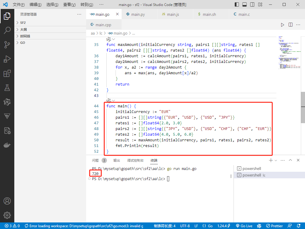

Go完整代码如下:
package main
import (
"fmt"
type pair struct {
to string
rate float64
func calcAmount(pairs [][]string, rates []float64, initialCurrency string) map[string]float64 {
g := map[string][]pair{}
for i, p := range pairs {
x, y, r := p[0], p[1], rates[i]
g[x] = append(g[x], pair{y, r})
g[y] = append(g[y], pair{x, 1 / r})
amount := map[string]float64{}
var dfs func(string, float64)
dfs = func(x string, curAmount float64) {
amount[x] = curAmount
for _, e := range g[x] {
// 每个节点只需递归一次(重复递归算出来的结果是一样的,因为题目保证汇率没有矛盾)
if amount[e.to] == 0 {
dfs(e.to, curAmount*e.rate)
dfs(initialCurrency, 1)
return amount
func maxAmount(initialCurrency string, pairs1 [][]string, rates1 []float64, pairs2 [][]string, rates2 []float64) (ans float64) {
day1Amount := calcAmount(pairs1, rates1, initialCurrency)
day2Amount := calcAmount(pairs2, rates2, initialCurrency)
for x, a2 := range day2Amount {
ans = max(ans, day1Amount[x]/a2)
return
func main() {
initialCurrency := "EUR"
pairs1 := [][]string{{"EUR", "USD"}, {"USD", "JPY"}}
rates1 := []float64{2.0, 3.0}
pairs2 := [][]string{{"JPY", "USD"}, {"USD", "CHF"}, {"CHF", "EUR"}}
rates2 := []float64{4.0, 5.0, 6.0}
result := maxAmount(initialCurrency, pairs1, rates1, pairs2, rates2)
fmt.Println(result)

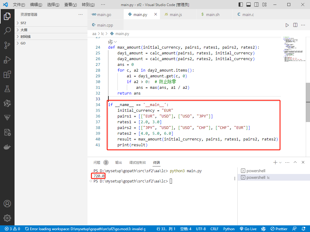

Python完整代码如下:
# -*-coding:utf-8-*-
from collections import defaultdict
def calc_amount(pairs, rates, initial_currency):
g = defaultdict(list)
for (start, end), rate in zip(pairs, rates):
g[start].append((end, rate))
g[end].append((start, 1 / rate))
amount = {}
def dfs(currency, cur_amount):
if currency in amount:
return
amount[currency] = cur_amount
for nxt, rate in g[currency]:
if nxt not in amount:
dfs(nxt, cur_amount * rate)
dfs(initial_currency, 1)
return amount
def max_amount(initial_currency, pairs1, rates1, pairs2, rates2):
day1_amount = calc_amount(pairs1, rates1, initial_currency)
day2_amount = calc_amount(pairs2, rates2, initial_currency)
ans = 0
for c, a2 in day2_amount.items():
a1 = day1_amount.get(c, 0)
if a2 > 0: # 防止除零
ans = max(ans, a1 / a2)
return ans
if __name__ == '__main__':
initial_currency = "EUR"
pairs1 = [["EUR", "USD"], ["USD", "JPY"]]
rates1 = [2.0, 3.0]
pairs2 = [["JPY", "USD"], ["USD", "CHF"], ["CHF", "EUR"]]
rates2 = [4.0, 5.0, 6.0]
result = max_amount(initial_currency, pairs1, rates1, pairs2, rates2)
print(result)
