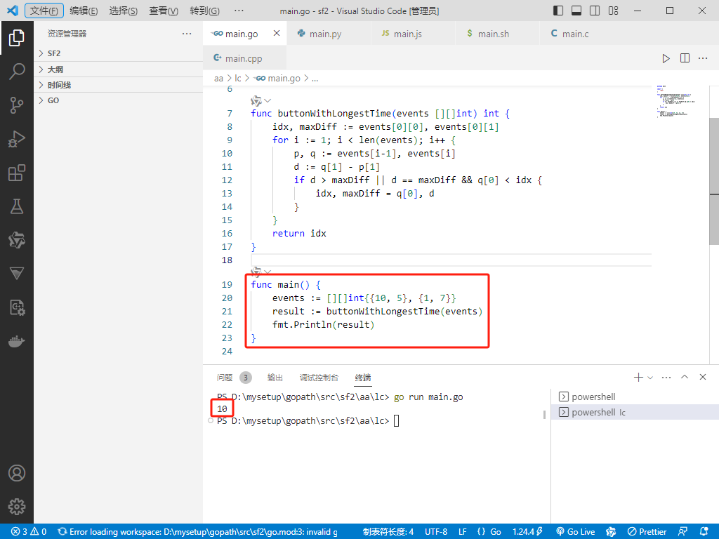

Go完整代码如下:
package main
import (
	"fmt"
func buttonWithLongestTime(events [][]int) int {
	idx, maxDiff := events[0][0], events[0][1]
	for i := 1; i < len(events); i++ {
		p, q := events[i-1], events[i]
		d := q[1] - p[1]
		if d > maxDiff || d == maxDiff && q[0] < idx {
			idx, maxDiff = q[0], d
	return idx
func main() {
	events := [][]int{{10, 5}, {1, 7}}
	result := buttonWithLongestTime(events)
	fmt.Println(result)

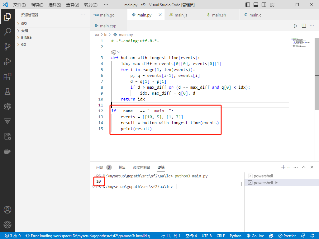

Python完整代码如下:
# -*-coding:utf-8-*-
def button_with_longest_time(events):
    idx, max_diff = events[0][0], events[0][1]
    for i in range(1, len(events)):
        p, q = events[i-1], events[i]
        d = q[1] - p[1]
        if d > max_diff or (d == max_diff and q[0] < idx):
            idx, max_diff = q[0], d
    return idx
if __name__ == "__main__":
    events = [[10, 5], [1, 7]]
    result = button_with_longest_time(events)
    print(result)
