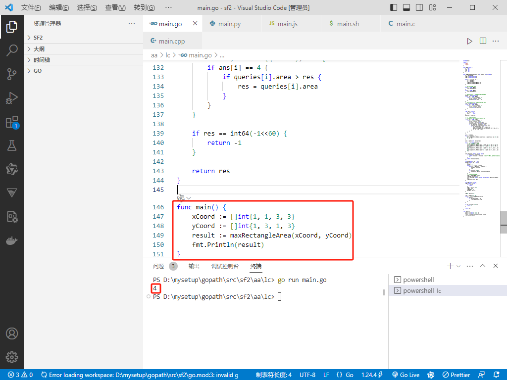

Go完整代码如下:
package main
import (
"fmt"
"sort"
type Node struct {
x, y int
val int
idx int
op int
func maxRectangleArea(xCoord []int, yCoord []int) int64 {
n := len(xCoord)
xMap := map[int][]int{}
yMap := map[int][]int{}
for i := 0; i < n; i++ {
x := xCoord[i]
y := yCoord[i]
xMap[x] = append(xMap[x], y)
yMap[y] = append(yMap[y], x)
// 对每个x,y坐标排序
for x := range xMap {
sort.Ints(xMap[x])
for y := range yMap {
sort.Ints(yMap[y])
// below[(x,y2)] = y1 纵向相邻点,下方点y1
below := map[[2]int]int{}
for x, ys := range xMap {
for i := 0; i+1 < len(ys); i++ {
y1, y2 := ys[i], ys[i+1]
below[[2]int{x, y2}] = y1
// left[(x2,y)] = x1 横向相邻点,左侧点x1
left := map[[2]int]int{}
for y, xs := range yMap {
for i := 0; i+1 < len(xs); i++ {
x1, x2 := xs[i], xs[i+1]
left[[2]int{x2, y}] = x1
type Query struct {
a, b, c, d int
area int64
queries := []Query{}
// 找所有符合条件的矩形
// 类似python中pairwise:遍历y的相邻配对
x1, ok1 := left[[2]int{x, y2}]
x1_check, ok2 := left[[2]int{x, y1}]
if ok1 && ok2 && x1_check == x1 {
y_below, ok3 := below[[2]int{x1, y2}]
if ok3 && y_below == y1 {
area := int64(y2-y1) * int64(x-x1)
queries = append(queries, Query{a: x1, b: y1, c: x, d: y2, area: area})
arr := []Node{}
arr = append(arr, Node{x: xCoord[i], y: yCoord[i], val: 0, idx: 0, op: 1})
ans := make([]int, len(queries))
for i, q := range queries {
// 构造查询点,和差分项
arr = append(arr, Node{x: q.c, y: q.d, val: 1, idx: i, op: 0})
arr = append(arr, Node{x: q.a - 1, y: q.b - 1, val: 1, idx: i, op: 0})
arr = append(arr, Node{x: q.c, y: q.b - 1, val: -1, idx: i, op: 0})
arr = append(arr, Node{x: q.a - 1, y: q.d, val: -1, idx: i, op: 0})
sort.Slice(arr, func(i, j int) bool {
if arr[i].x == arr[j].x {
return arr[i].op > arr[j].op // op=1放前面,和python“-e.op”对应
return arr[i].x < arr[j].x
var merge func(l, m, r int)
merge = func(l, m, r int) {
j := l
point := 0
for i := m + 1; i <= r; i++ {
for j <= m && arr[j].y <= arr[i].y {
point += arr[j].op
j++
if arr[i].op == 0 {
ans[arr[i].idx] += arr[i].val * point
// 按y排序,方便合并
tmp := make([]Node, r-l+1)
copy(tmp, arr[l:r+1])
sort.Slice(tmp, func(i, j int) bool { return tmp[i].y < tmp[j].y })
copy(arr[l:r+1], tmp)
var cdq func(l, r int)
cdq = func(l, r int) {
if l >= r {
return
mid := (l + r) >> 1
cdq(l, mid)
cdq(mid+1, r)
merge(l, mid, r)
cdq(0, len(arr)-1)
res := int64(-1 << 60)
for i := 0; i < len(queries); i++ {
if ans[i] == 4 {
if queries[i].area > res {
res = queries[i].area
if res == int64(-1<<60) {
return -1
return res
func main() {
xCoord := []int{1, 1, 3, 3}
yCoord := []int{1, 3, 1, 3}
result := maxRectangleArea(xCoord, yCoord)
fmt.Println(result)
