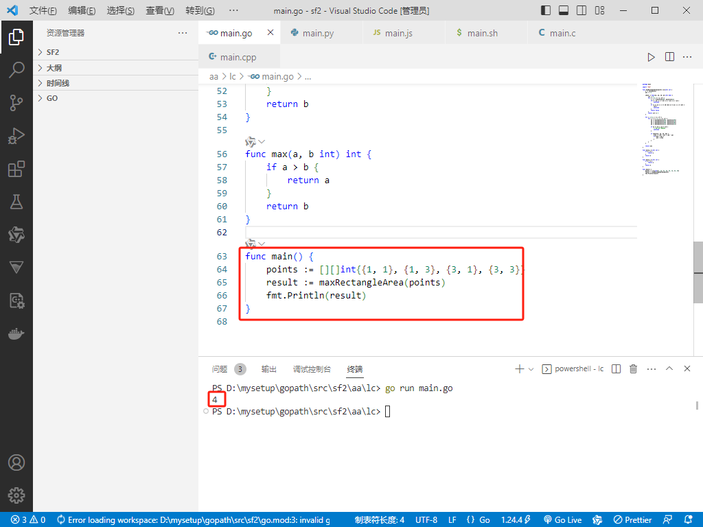

Go完整代码如下:
package main
import "fmt"
func maxRectangleArea(points [][]int) int {
	n := len(points)
	ans := -1
	check := func(xa, ya, xb, yb int) bool {
		cnt := 0
		for k := 0; k < n; k++ {
			x, y := points[k][0], points[k][1]
			if x < xa || x > xb || y < ya || y > yb {
				continue
			if (x == xa || x == xb) && (y == ya || y == yb) {
				cnt++
				continue
			return false
		return cnt == 4
	for i := 0; i < n; i++ {
		for j := i + 1; j < n; j++ {
			xa := min(points[i][0], points[j][0])
			ya := min(points[i][1], points[j][1])
			xb := max(points[i][0], points[j][0])
			yb := max(points[i][1], points[j][1])
			if xa == xb || ya == yb {
				// 不是矩形的对角
				continue
			if check(xa, ya, xb, yb) {
				area := (xb - xa) * (yb - ya)
				if area > ans {
					ans = area
	return ans
func min(a, b int) int {
	if a < b {
		return a
	return b
func max(a, b int) int {
	if a > b {
		return a
	return b
func main() {
	points := [][]int{{1, 1}, {1, 3}, {3, 1}, {3, 3}}
	result := maxRectangleArea(points)
	fmt.Println(result)

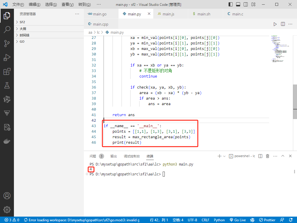

Python完整代码如下:
# -*-coding:utf-8-*-
def min_val(a, b):
    return a if a < b else b
def max_val(a, b):
    return a if a > b else b
def max_rectangle_area(points):
    n = len(points)
    ans = -1
    def check(xa, ya, xb, yb):
        cnt = 0
        for k in range(n):
            x, y = points[k]
            if x < xa or x > xb or y < ya or y > yb:
                continue
            if (x == xa or x == xb) and (y == ya or y == yb):
                cnt += 1
                continue
            return False
        return cnt == 4
    for i in range(n):
        for j in range(i + 1, n):
            xa = min_val(points[i][0], points[j][0])
            ya = min_val(points[i][1], points[j][1])
            xb = max_val(points[i][0], points[j][0])
            yb = max_val(points[i][1], points[j][1])
            if xa == xb or ya == yb:
                # 不是矩形的对角
                continue
            if check(xa, ya, xb, yb):
                area = (xb - xa) * (yb - ya)
                if area > ans:
                    ans = area
    return ans
if __name__ == '__main__':
    points = [[1,1], [1,3], [3,1], [3,3]]
    result = max_rectangle_area(points)
    print(result)
