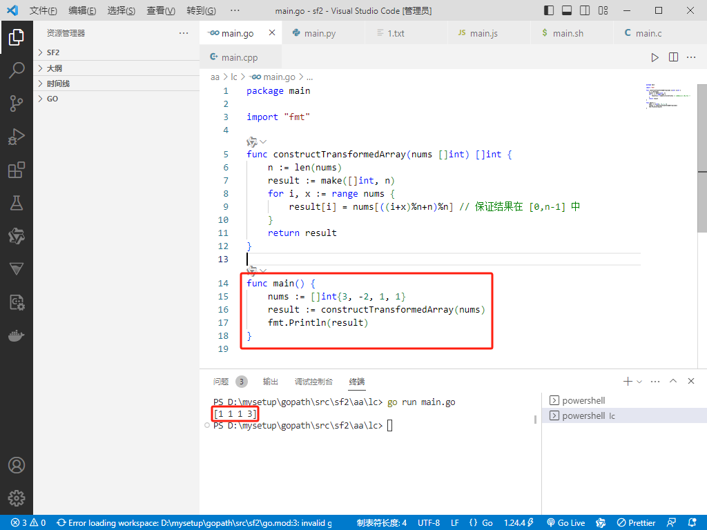

Go完整代码如下:
package main
import "fmt"
func constructTransformedArray(nums []int) []int {
	n := len(nums)
	result := make([]int, n)
	for i, x := range nums {
		result[i] = nums[((i+x)%n+n)%n] // 保证结果在 [0,n-1] 中
	return result
func main() {
	nums := []int{3, -2, 1, 1}
	result := constructTransformedArray(nums)
	fmt.Println(result)

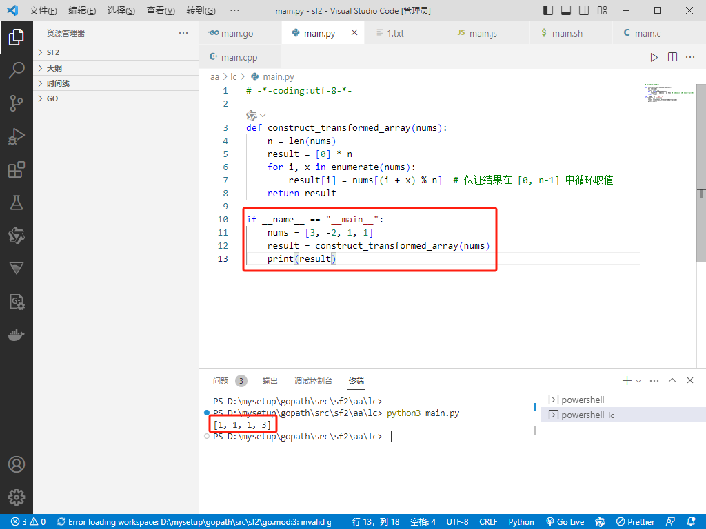

Python完整代码如下:
# -*-coding:utf-8-*-
def construct_transformed_array(nums):
    n = len(nums)
    result = [0] * n
    for i, x in enumerate(nums):
        result[i] = nums[(i + x) % n]  # 保证结果在 [0, n-1] 中循环取值
    return result
if __name__ == "__main__":
    nums = [3, -2, 1, 1]
    result = construct_transformed_array(nums)
    print(result)
