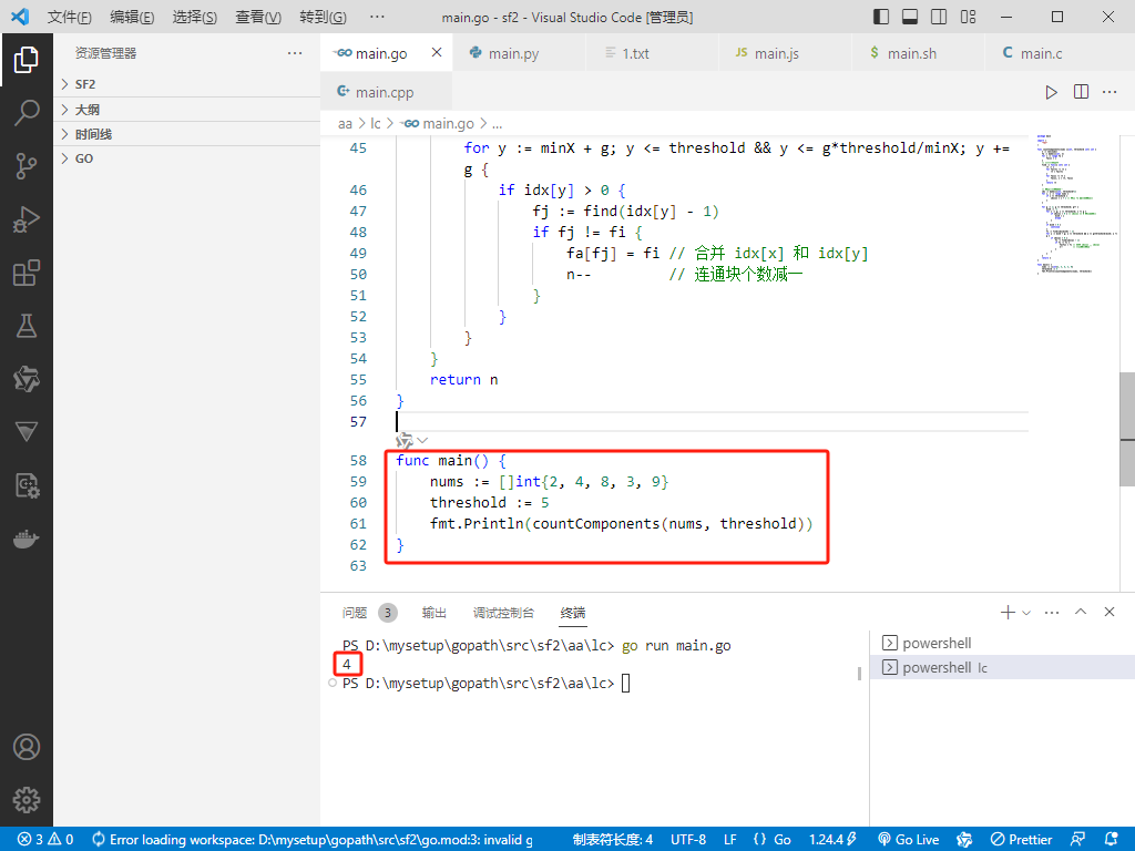

	nums := []int{2, 4, 8, 3, 9}
	threshold := 5
	fmt.Println(countComponents(nums, threshold))

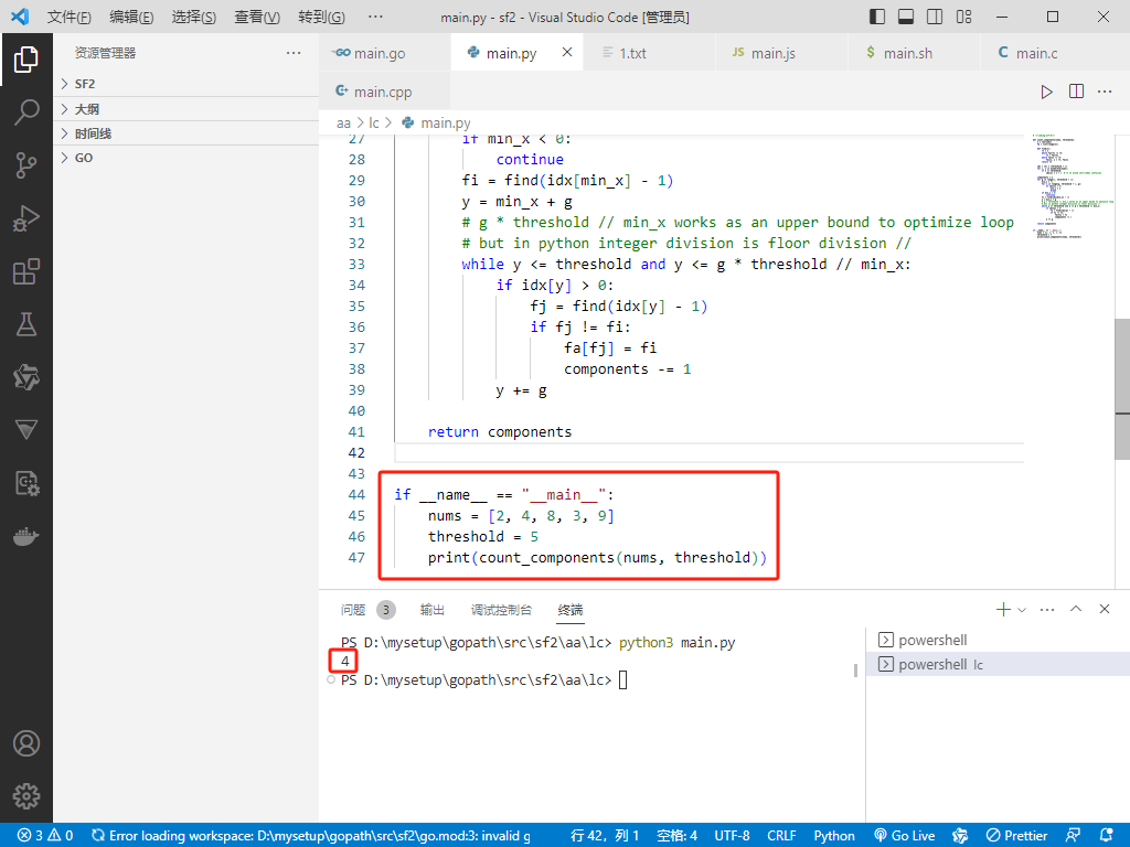

if __name__ == "__main__":
    nums = [2, 4, 8, 3, 9]
    threshold = 5
    print(count_components(nums, threshold))
