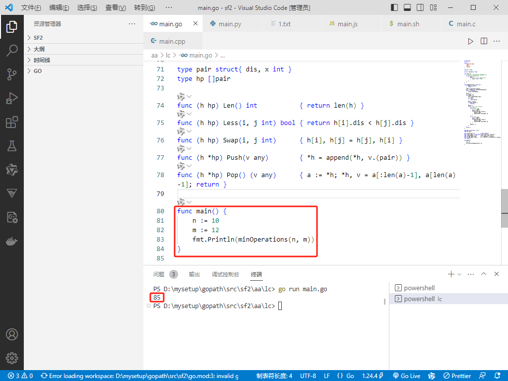

Go完整代码如下:
package main
import (
	"container/heap"
	"fmt"
	"math"
	"strconv"
const mx = 10000
var np = [mx]bool{1: true}
func init() {
	// 埃氏筛,标记每个数是否为合数(或者 1)
	for i := 2; i < mx; i++ {
		if !np[i] {
			for j := i * i; j < mx; j += i {
				np[j] = true // 合数
func minOperations(n, m int) int {
	if !np[n] || !np[m] {
		return -1
	lenN := len(strconv.Itoa(n))
	dis := make([]int, int(math.Pow10(lenN)))
	for i := range dis {
		dis[i] = math.MaxInt
	dis[n] = n
	h := hp{{n, n}}
	for len(h) > 0 {
		top := heap.Pop(&h).(pair)
		x := top.x
		if x == m {
			return top.dis
		disX := top.dis
		if disX > dis[x] {
			continue
		pow10 := 1
		for v := x; v > 0; v /= 10 {
			d := v % 10
			if d > 0 { // 减少
				y := x - pow10
				newD := disX + y
				if np[y] && newD < dis[y] {
					dis[y] = newD
					heap.Push(&h, pair{newD, y})
			if d < 9 { // 增加
				y := x + pow10
				newD := disX + y
					dis[y] = newD
			pow10 *= 10
	return -1
type pair struct{ dis, x int }
type hp []pair
func (h hp) Len() int           { return len(h) }
func (h hp) Less(i, j int) bool { return h[i].dis < h[j].dis }
func (h hp) Swap(i, j int)      { h[i], h[j] = h[j], h[i] }
func (h *hp) Push(v any)        { *h = append(*h, v.(pair)) }
func (h *hp) Pop() (v any)      { a := *h; *h, v = a[:len(a)-1], a[len(a)-1]; return }
func main() {
	n := 10
	m := 12
	fmt.Println(minOperations(n, m))

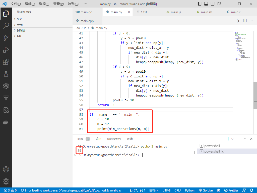

Python完整代码如下:
# -*-coding:utf-8-*-
import heapq
import math
MAX = 10000
# np[i] == True 表示 i 是合数或 1,不是质数
np = [False] * MAX
np[1] = True
for i in range(2, int(math.sqrt(MAX)) + 1):
    if not np[i]:
        for j in range(i * i, MAX, i):
            np[j] = True
def min_operations(n: int, m: int) -> int:
    if not np[n] or not np[m]:
        return -1
    len_n = len(str(n))
    limit = 10 ** len_n
    dis = [math.inf] * limit
    dis[n] = n
    heap = [(n, n)]  # (dist, x)
    while heap:
        dist_x, x = heapq.heappop(heap)
        if x == m:
            return dist_x
        if dist_x > dis[x]:
            continue
        pow10 = 1
        v = x
        digits = []
        for _ in range(len_n):
            digits.append(v % 10)
            v //= 10
        for i, d in enumerate(digits):
            if d > 0:
                y = x - pow10
                if y < limit and np[y]:
                    new_dist = dist_x + y
                    if new_dist < dis[y]:
                        dis[y] = new_dist
                        heapq.heappush(heap, (new_dist, y))
            if d < 9:
                y = x + pow10
                        dis[y] = new_dist
            pow10 *= 10
    return -1
if __name__ == "__main__":
    n = 10
    m = 12
    print(min_operations(n, m))
