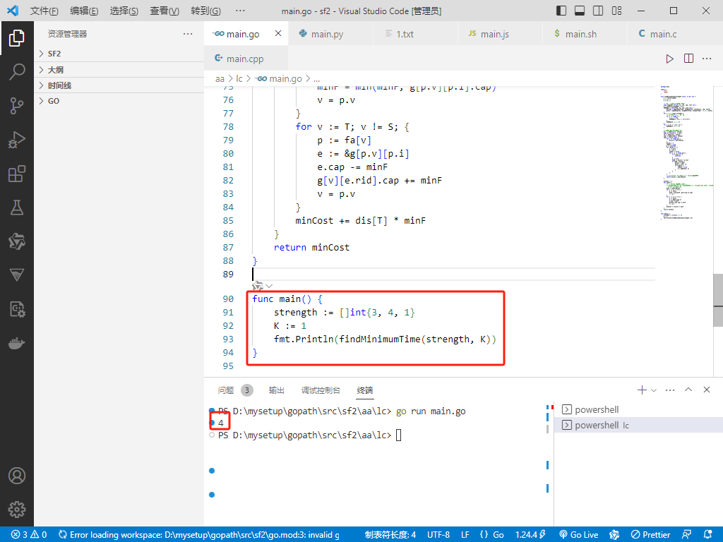

Go完整代码如下:
package main
import (
	"fmt"
	"math"
func findMinimumTime(strength []int, k int) int {
	n := len(strength)
	S := n * 2
	T := S + 1
	// rid 为反向边在邻接表中的下标
	type neighbor struct{ to, rid, cap, cost int }
	g := make([][]neighbor, T+1)
	addEdge := func(from, to, cap, cost int) {
		g[from] = append(g[from], neighbor{to, len(g[to]), cap, cost})
		g[to] = append(g[to], neighbor{from, len(g[from]) - 1, 0, -cost})
	for i, s := range strength {
		// 枚举这个锁是第几次开的
		for j := range n {
			x := 1 + k*j
			addEdge(i, n+j, 1, (s-1)/x+1)
		addEdge(S, i, 1, 0)
	for i := n; i < n*2; i++ {
		addEdge(i, T, 1, 0)
	// 下面是最小费用最大流模板
	dis := make([]int, len(g))
	type vi struct{ v, i int }
	fa := make([]vi, len(g))
	inQ := make([]bool, len(g))
	spfa := func() bool {
		for i := range dis {
			dis[i] = math.MaxInt
		dis[S] = 0
		inQ[S] = true
		q := []int{S}
		for len(q) > 0 {
			v := q[0]
			q = q[1:]
			inQ[v] = false
			for i, e := range g[v] {
				if e.cap == 0 {
					continue
				w := e.to
				newD := dis[v] + e.cost
				if newD < dis[w] {
					dis[w] = newD
					fa[w] = vi{v, i}
					if !inQ[w] {
						inQ[w] = true
						q = append(q, w)
		// 循环结束后所有 inQ[v] 都为 false,无需重置
		return dis[T] < math.MaxInt
	minCost := 0
	for spfa() {
		// 沿 st-end 的最短路尽量增广
		// 特别地,如果建图时所有边的容量都设为 1,那么 minF 必然为 1,下面第一个 for 循环可以省略
		minF := math.MaxInt
		for v := T; v != S; {
			p := fa[v]
			minF = min(minF, g[p.v][p.i].cap)
			v = p.v
			p := fa[v]
			e := &g[p.v][p.i]
			e.cap -= minF
			g[v][e.rid].cap += minF
			v = p.v
		minCost += dis[T] * minF
	return minCost
func main() {
	strength := []int{3, 4, 1}
	K := 1
	fmt.Println(findMinimumTime(strength, K))

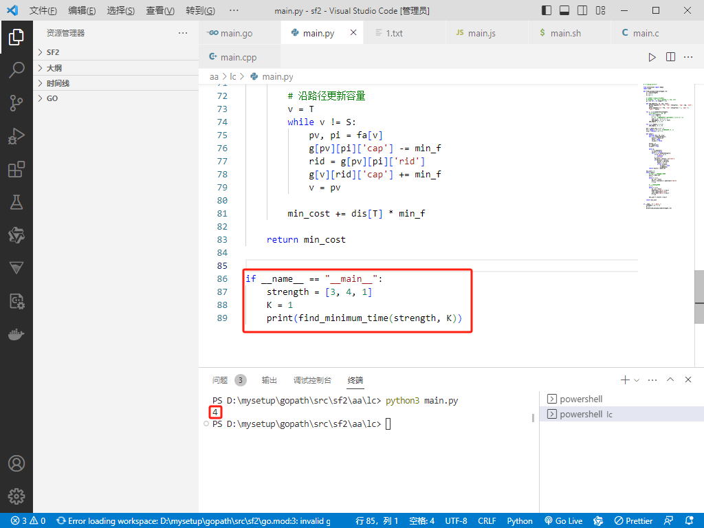

# -*-coding:utf-8-*-
from collections import deque
import math
def find_minimum_time(strength, K):
    n = len(strength)
    S = n * 2
    T = S + 1
    # 邻接表中每条边用字典表示
    # neighbor: to, rid (反向边下标), cap, cost
    g = [[] for _ in range(T + 1)]
    def add_edge(frm, to, cap, cost):
        g[frm].append({'to': to, 'rid': len(g[to]), 'cap': cap, 'cost': cost})
        g[to].append({'to': frm, 'rid': len(g[frm]) - 1, 'cap': 0, 'cost': -cost})
    for i, s in enumerate(strength):
        # 枚举这个锁是第几次开的
        for j in range(n):
            x = 1 + K * j
            # 计算开锁需要的时间 (向上取整用 (s-1)//x + 1)
            cost = (s - 1) // x + 1
            add_edge(i, n + j, 1, cost)
        add_edge(S, i, 1, 0)
    for i in range(n, n * 2):
        add_edge(i, T, 1, 0)
    dis = [math.inf] * (T + 1)
    fa = [None] * (T + 1)  # 存父节点 (v, i)
    in_q = [False] * (T + 1)
    def spfa():
        nonlocal dis, fa, in_q
        for i in range(len(dis)):
            dis[i] = math.inf
            fa[i] = None
            in_q[i] = False
        dis[S] = 0
        q = deque([S])
        in_q[S] = True
        while q:
            v = q.popleft()
            in_q[v] = False
            for i, e in enumerate(g[v]):
                if e['cap'] == 0:
                    continue
                w = e['to']
                new_dist = dis[v] + e['cost']
                if new_dist < dis[w]:
                    dis[w] = new_dist
                    fa[w] = (v, i)
                    if not in_q[w]:
                        in_q[w] = True
                        q.append(w)
        return dis[T] < math.inf
    min_cost = 0
    while spfa():
        # 找到增广路径的最小容量
        min_f = math.inf
        v = T
        while v != S:
            pv, pi = fa[v]
            min_f = min(min_f, g[pv][pi]['cap'])
            v = pv
        # 沿路径更新容量
        v = T
        while v != S:
            pv, pi = fa[v]
            g[pv][pi]['cap'] -= min_f
            rid = g[pv][pi]['rid']
            g[v][rid]['cap'] += min_f
            v = pv
        min_cost += dis[T] * min_f
    return min_cost
if __name__ == "__main__":
    strength = [3, 4, 1]
    K = 1
    print(find_minimum_time(strength, K))
