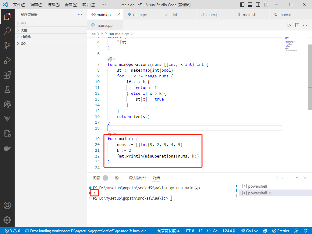

Go完整代码如下:
package main
import (
"fmt"
func minOperations(nums []int, k int) int {
st := make(map[int]bool)
for _, x := range nums {
if x < k {
return -1
} else if x > k {
st[x] = true
return len(st)
func main() {
nums := []int{5, 2, 5, 4, 5}
k := 2
fmt.Println(minOperations(nums, k))

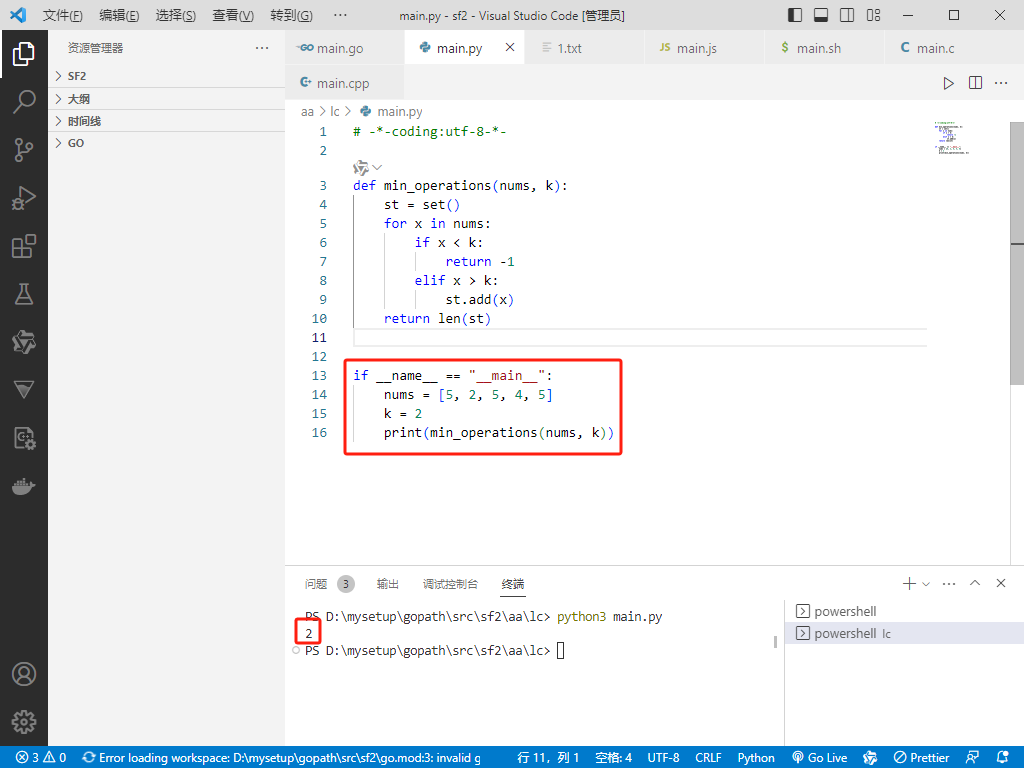

Python完整代码如下:
# -*-coding:utf-8-*-
def min_operations(nums, k):
st = set()
for x in nums:
if x < k:
return -1
elif x > k:
st.add(x)
return len(st)
if __name__ == "__main__":
nums = [5, 2, 5, 4, 5]
k = 2
print(min_operations(nums, k))
