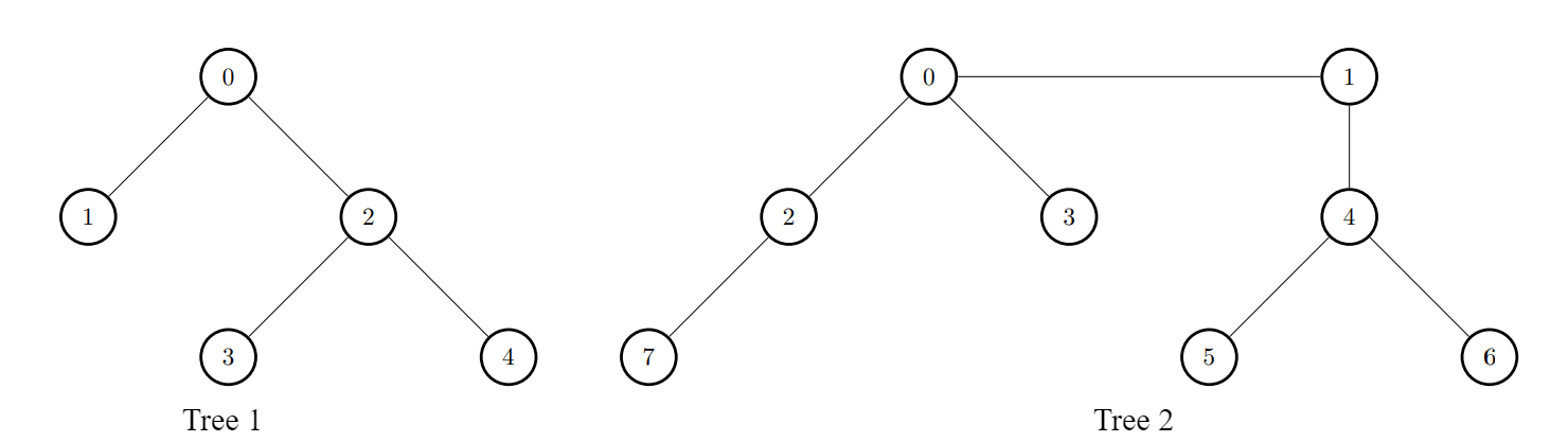

输入:edges1 = [[0,1],[0,2],[2,3],[2,4]], edges2 = [[0,1],[0,2],[0,3],[2,7],[1,4],[4,5],[4,6]]。
输出:[8,7,7,8,8]。
解释:
对于 i = 0 ,连接第一棵树中的节点 0 和第二棵树中的节点 0 。
对于 i = 1 ,连接第一棵树中的节点 1 和第二棵树中的节点 4 。
对于 i = 2 ,连接第一棵树中的节点 2 和第二棵树中的节点 7 。
对于 i = 3 ,连接第一棵树中的节点 3 和第二棵树中的节点 0 。
对于 i = 4 ,连接第一棵树中的节点 4 和第二棵树中的节点 4 。
题目来自力扣3373。

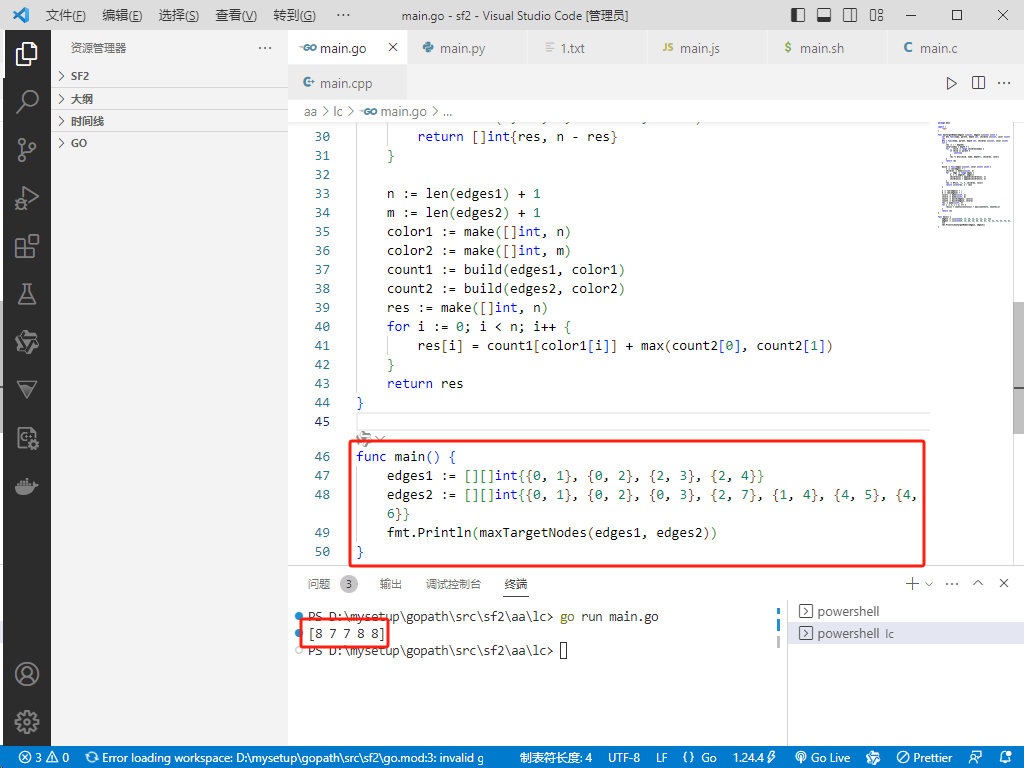

Go完整代码如下:
package main
import (
	"fmt"
func maxTargetNodes(edges1 [][]int, edges2 [][]int) []int {
	var dfs func(node, parent, depth int, children [][]int, color []int) int
	dfs = func(node, parent, depth int, children [][]int, color []int) int {
		res := 1 - depth%2
		color[node] = depth % 2
		for _, child := range children[node] {
			if child == parent {
				continue
			res += dfs(child, node, depth+1, children, color)
		return res
	build := func(edges [][]int, color []int) []int {
		n := len(edges) + 1
		children := make([][]int, n)
		for _, edge := range edges {
			u, v := edge[0], edge[1]
			children[u] = append(children[u], v)
			children[v] = append(children[v], u)
		res := dfs(0, -1, 0, children, color)
		return []int{res, n - res}
	n := len(edges1) + 1
	m := len(edges2) + 1
	color1 := make([]int, n)
	color2 := make([]int, m)
	count1 := build(edges1, color1)
	count2 := build(edges2, color2)
	res := make([]int, n)
	for i := 0; i < n; i++ {
		res[i] = count1[color1[i]] + max(count2[0], count2[1])
	return res
func main() {
	edges1 := [][]int{{0, 1}, {0, 2}, {2, 3}, {2, 4}}
	edges2 := [][]int{{0, 1}, {0, 2}, {0, 3}, {2, 7}, {1, 4}, {4, 5}, {4, 6}}
	fmt.Println(maxTargetNodes(edges1, edges2))

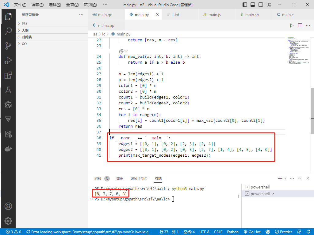

Python完整代码如下:
# -*-coding:utf-8-*-
from typing import List
def max_target_nodes(edges1: List[List[int]], edges2: List[List[int]]) -> List[int]:
    def dfs(node: int, parent: int, depth: int, children: List[List[int]], color: List[int]) -> int:
        res = 1 - depth % 2
        for child in children[node]:
            if child == parent:
                continue
            res += dfs(child, node, depth + 1, children, color)
        return res
    def build(edges: List[List[int]], color: List[int]) -> List[int]:
        n = len(edges) + 1
        children = [[] for _ in range(n)]
        for u, v in edges:
            children[u].append(v)
            children[v].append(u)
        res = dfs(0, -1, 0, children, color)
        return [res, n - res]
    def max_val(a: int, b: int) -> int:
        return a if a > b else b
    n = len(edges1) + 1
    m = len(edges2) + 1
    color1 = [0] * n
    color2 = [0] * m
    count1 = build(edges1, color1)
    count2 = build(edges2, color2)
    res = [0] * n
    for i in range(n):
        res[i] = count1[color1[i]] + max_val(count2[0], count2[1])
    return res
if __name__ == '__main__':
    edges1 = [[0, 1], [0, 2], [2, 3], [2, 4]]
    edges2 = [[0, 1], [0, 2], [0, 3], [2, 7], [1, 4], [4, 5], [4, 6]]
    print(max_target_nodes(edges1, edges2))
