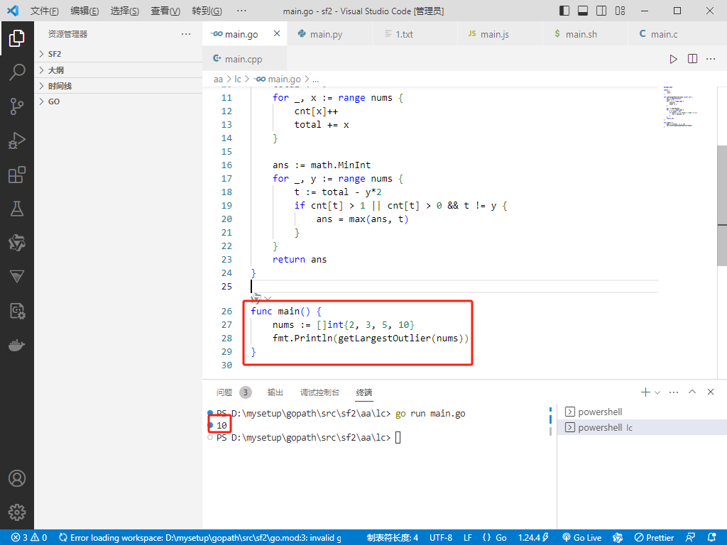

Go完整代码如下:
package main
import (
	"fmt"
	"math"
func getLargestOutlier(nums []int) int {
	cnt := map[int]int{}
	total := 0
	for _, x := range nums {
		cnt[x]++
		total += x
	ans := math.MinInt
	for _, y := range nums {
		t := total - y*2
		if cnt[t] > 1 || cnt[t] > 0 && t != y {
			ans = max(ans, t)
	return ans
func main() {
	nums := []int{2, 3, 5, 10}
	fmt.Println(getLargestOutlier(nums))

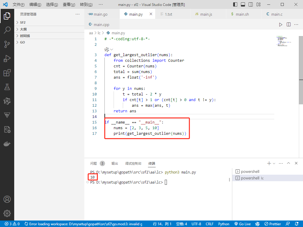

Python完整代码如下:
# -*-coding:utf-8-*-
def get_largest_outlier(nums):
    from collections import Counter
    cnt = Counter(nums)
    total = sum(nums)
    ans = float('-inf')
    for y in nums:
        t = total - 2 * y
        if cnt[t] > 1 or (cnt[t] > 0 and t != y):
            ans = max(ans, t)
    return ans
if __name__ == "__main__":
    nums = [2, 3, 5, 10]
    print(get_largest_outlier(nums))
