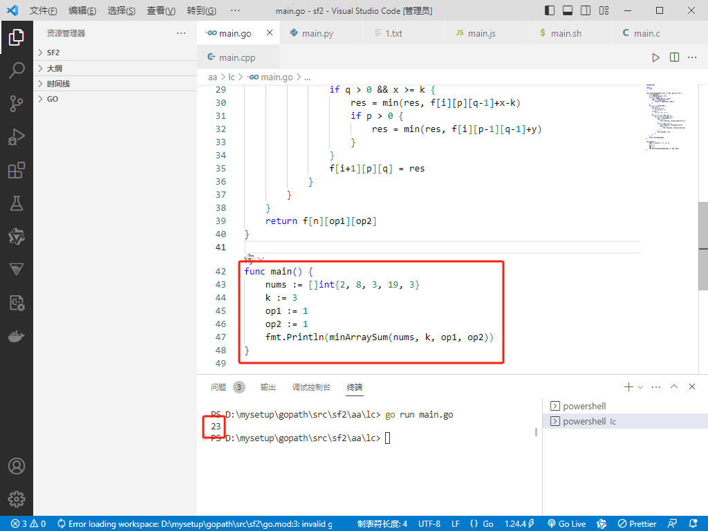

Go完整代码如下:
package main
import (
	"fmt"
func minArraySum(nums []int, k, op1, op2 int) int {
	n := len(nums)
	f := make([][][]int, n+1)
	for i := range f {
		f[i] = make([][]int, op1+1)
		for j := range f[i] {
			f[i][j] = make([]int, op2+1)
	for i, x := range nums {
		var y int
		if (x+1)/2 >= k {
			y = (x+1)/2 - k
		} else {
			y = (x - k + 1) / 2
		for p := 0; p <= op1; p++ {
			for q := 0; q <= op2; q++ {
				res := f[i][p][q] + x
				if p > 0 {
					res = min(res, f[i][p-1][q]+(x+1)/2)
				if q > 0 && x >= k {
					res = min(res, f[i][p][q-1]+x-k)
					if p > 0 {
						res = min(res, f[i][p-1][q-1]+y)
				f[i+1][p][q] = res
	return f[n][op1][op2]
func main() {
	nums := []int{2, 8, 3, 19, 3}
	k := 3
	op1 := 1
	op2 := 1
	fmt.Println(minArraySum(nums, k, op1, op2))

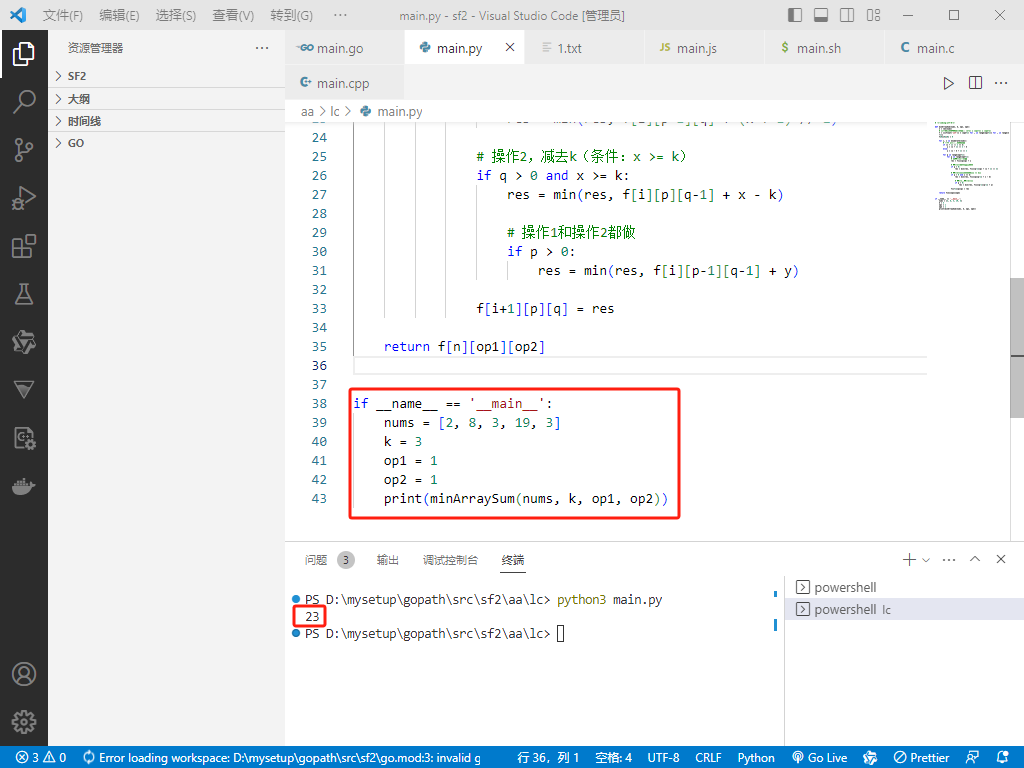

Python完整代码如下:
# -*-coding:utf-8-*-
def minArraySum(nums, k, op1, op2):
    n = len(nums)
    # 初始化三维DP数组,维度为 (n+1) x (op1+1) x (op2+1)
    f = [[[float('inf')] * (op2+1) for _ in range(op1+1)] for _ in range(n+1)]
    f[0][0][0] = 0
    for i, x in enumerate(nums):
        # 计算 y,基于题意处理
        if (x + 1) // 2 >= k:
            y = (x + 1) // 2 - k
        else:
            y = (x - k + 1) // 2
        for p in range(op1+1):
            for q in range(op2+1):
                # 不操作当前元素
                res = f[i][p][q] + x
                # 操作1,除以2向上取整
                if p > 0:
                    res = min(res, f[i][p-1][q] + (x + 1) // 2)
                # 操作2,减去k(条件:x >= k)
                if q > 0 and x >= k:
                    res = min(res, f[i][p][q-1] + x - k)
                    # 操作1和操作2都做
                    if p > 0:
                        res = min(res, f[i][p-1][q-1] + y)
                f[i+1][p][q] = res
if __name__ == '__main__':
    nums = [2, 8, 3, 19, 3]
    k = 3
    op1 = 1
    op2 = 1
    print(minArraySum(nums, k, op1, op2))
