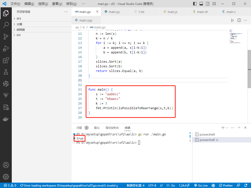

Go完整代码如下:
package main
import (
	"fmt"
	"slices"
func isPossibleToRearrange(s, t string, k int) bool {
	a := make([]string, 0, k) // 预分配空间
	b := make([]string, 0, k)
	n := len(s)
	k = n / k
	for i := k; i <= n; i += k {
		a = append(a, s[i-k:i])
		b = append(b, t[i-k:i])
	slices.Sort(a)
	slices.Sort(b)
	return slices.Equal(a, b)
func main() {
	s := "aabbcc"
	t := "bbaacc"
	k := 3
	fmt.Println(isPossibleToRearrange(s,t,k))

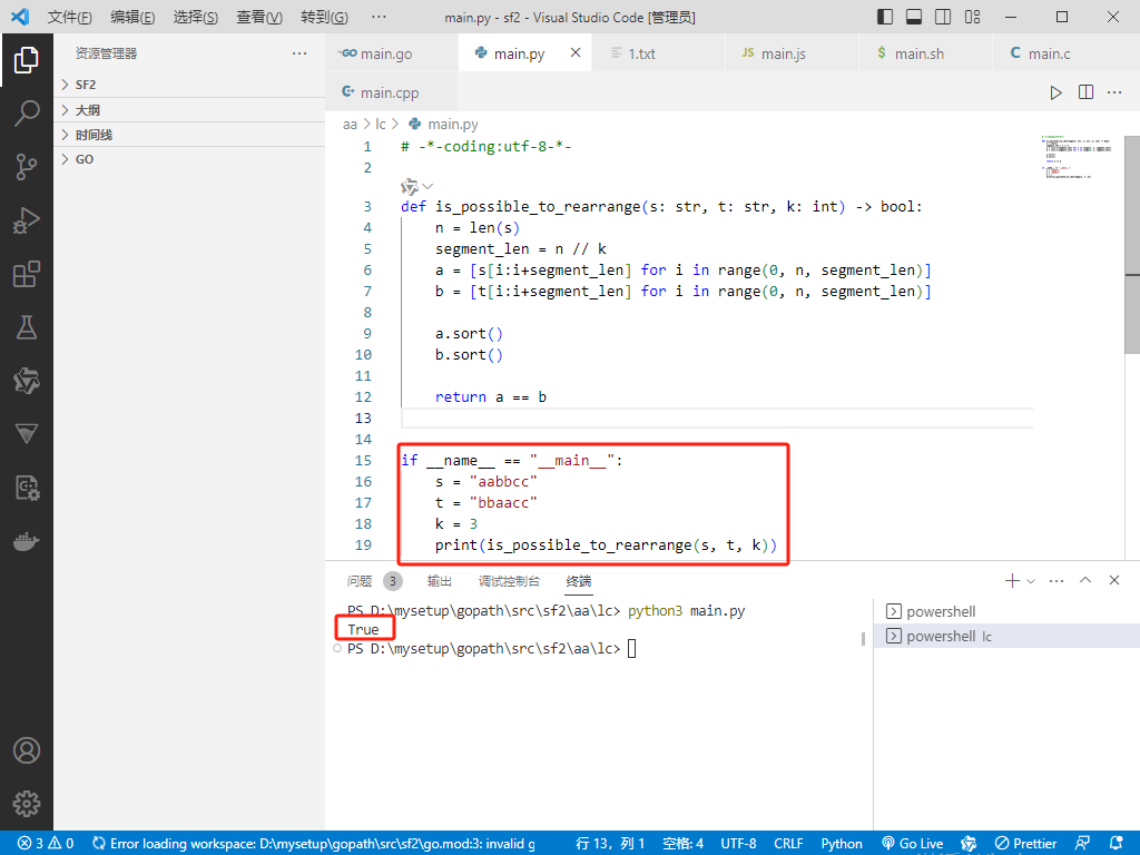

Python完整代码如下:
# -*-coding:utf-8-*-
def is_possible_to_rearrange(s: str, t: str, k: int) -> bool:
    n = len(s)
    segment_len = n // k
    a = [s[i:i+segment_len] for i in range(0, n, segment_len)]
    b = [t[i:i+segment_len] for i in range(0, n, segment_len)]
    a.sort()
    b.sort()
    return a == b
if __name__ == "__main__":
    s = "aabbcc"
    t = "bbaacc"
    k = 3
    print(is_possible_to_rearrange(s, t, k))
