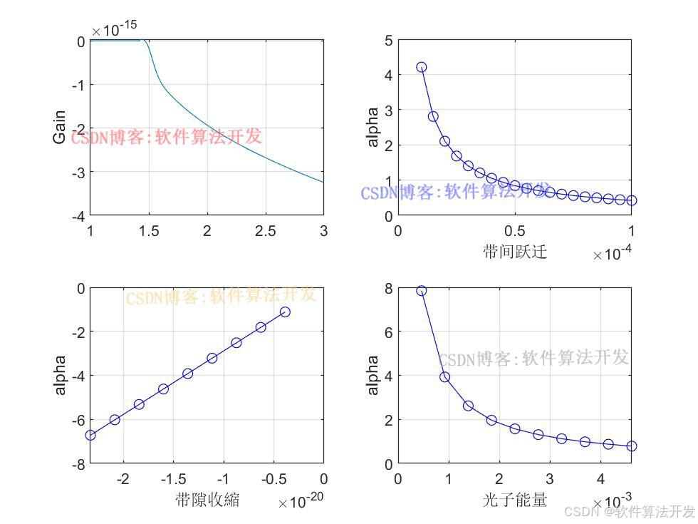

1.程序功能描述
       基于自混合干涉测量系统的线展宽因子估计算法matlab仿真。对比分析自由载流子效应对a因子影响,带间跃迁对量子拼材料a因子的影响,带隙收縮对a因子影响,自由载流子效应对a因子影响。
2.测试软件版本以及运行结果展示
MATLAB2022A版本运行

%自由载流子效应对a因子影响
dgdN  = 1.385e-15;
Eg    = [1.5134e-3:1.5134e-3:1.5134e-2]*mean(signal.^2);%信号功率抓好为光子能量;
h     = 4.21e3;
n     = 3.6071;
m     = 1.13e-2;
e0    = 3.12e-2;
c     = 1e8;
q     = 1.23e-8;
for i = 1:length(Eg)
    alpha3(i) = h*q*q/(m*e0*n*Eg(i)*c*dgdN);
end
subplot(224);
plot(Eg,alpha3,'b-o');
grid on
xlabel('光子能量');
ylabel('alpha');
%带间跃迁对量子拼材料a因子的影响
dhwdN = 8.08e-21;
dgdN  = 1.385e-15;
n     = 3.6071;
hc    = [9e-5:-0.9e-5:0.9e-5];
for i = 1:length(hc)
    alpha1_(i) = 2*n*dhwdN/hc(i)/dgdN;
end
%带隙收縮对a因子影响
dgdN  = 1.385e-15;
n     = 3.6071;
N     = 2.278e18;
hc    = [10e-5:-1e-5:1e-5];
dEgdN = [-1.6e-8]*(2)^(1/3)*(1/3)*N^(-2/3);
    alpha2_(i) = 2*n*dEgdN/hc(i)/dgdN;
end
%自由载流子效应对a因子影响
dgdN  = 1.385e-15;
Eg    = [4.5134e-3]*mean(signal.^2);%信号功率抓好为光子能量
h     = [10e3:-1e3:1e3];
n     = 3.6071;
m     = 1.13e-2;
e0    = 3.12e-2;
c     = 1e8;
q     = 0.23e-8;
for i = 1:length(h)
    alpha3_(i) = h(i)*q*q/(m*e0*n*Eg*c*dgdN);
end
figure;
plot(alpha1_,'b-o')
hold on
plot(alpha2_,'b-s')
hold on
plot(alpha3_,'b-*')
hold on
plot(alpha1_+alpha2_+alpha3_,'r-s')
grid on
ylabel('alpha');
legend('a_1','a_2','a_3','a');
save R0.mat alpha1_ alpha2_ alpha3_
