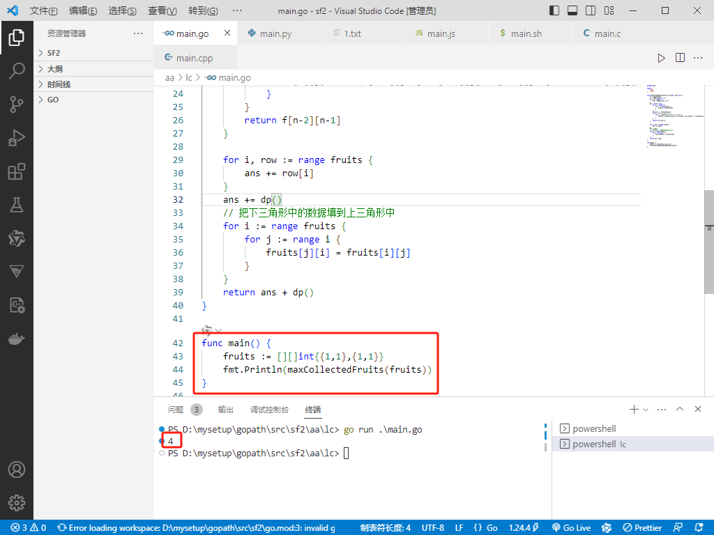

Go完整代码如下:
package main
import (
	"fmt"
	"math"
func maxCollectedFruits(fruits [][]int) (ans int) {
	n := len(fruits)
	f := make([][]int, n-1)
	for i := range f {
		f[i] = make([]int, n+1)
	dp := func() int {
		for i := range f {
			for j := range f[i] {
				f[i][j] = math.MinInt
		f[0][n-1] = fruits[0][n-1]
		for i := 1; i < n-1; i++ {
			for j := max(n-1-i, i+1); j < n; j++ {
				f[i][j] = max(f[i-1][j-1], f[i-1][j], f[i-1][j+1]) + fruits[i][j]
		return f[n-2][n-1]
	for i, row := range fruits {
		ans += row[i]
	ans += dp()
	// 把下三角形中的数据填到上三角形中
	for i := range fruits {
		for j := range i {
			fruits[j][i] = fruits[i][j]
	return ans + dp()
func main() {
	fruits := [][]int{{1,1},{1,1}}
	fmt.Println(maxCollectedFruits(fruits))

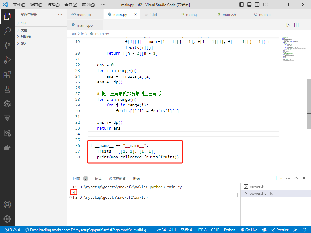

Python完整代码如下:
# -*-coding:utf-8-*-
import math
def max_collected_fruits(fruits):
    n = len(fruits)
    # 初始化二维数组 f
    f = [[-math.inf] * (n + 1) for _ in range(n - 1)]
    def dp():
        # 初始化f
        for i in range(n - 1):
            for j in range(n + 1):
                f[i][j] = -math.inf
        f[0][n - 1] = fruits[0][n - 1]
        for i in range(1, n - 1):
            for j in range(max(n - 1 - i, i + 1), n):
                f[i][j] = max(f[i - 1][j - 1], f[i - 1][j], f[i - 1][j + 1]) + fruits[i][j]
        return f[n - 2][n - 1]
    ans = 0
    for i in range(n):
        ans += fruits[i][i]
    ans += dp()
    # 把下三角形的数据填到上三角形中
    for i in range(n):
        for j in range(i):
    ans += dp()
    return ans
if __name__ == "__main__":
    fruits = [[1, 1], [1, 1]]
    print(max_collected_fruits(fruits))
