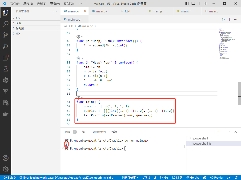

Go完整代码如下:
package main
import (
	"container/heap"
	"fmt"
	"sort"
func maxRemoval(nums []int, queries [][]int) int {
	sort.Slice(queries, func(i, j int) bool {
		return queries[i][0] < queries[j][0]
	pq := &Heap{}
	heap.Init(pq)
	deltaArray := make([]int, len(nums)+1)
	operations := 0
	for i, j := 0, 0; i < len(nums); i++ {
		operations += deltaArray[i]
		for j < len(queries) && queries[j][0] == i {
			heap.Push(pq, queries[j][1])
			j++
		for operations < nums[i] && pq.Len() > 0 && (*pq)[0] >= i {
			operations += 1
			deltaArray[heap.Pop(pq).(int)+1] -= 1
		if operations < nums[i] {
			return -1
	return pq.Len()
type Heap []int
func (h Heap) Len() int {
	return len(h)
func (h Heap) Less(i, j int) bool {
	return h[i] > h[j]
func (h Heap) Swap(i, j int) {
	h[i], h[j] = h[j], h[i]
func (h *Heap) Push(x interface{}) {
	*h = append(*h, x.(int))
func (h *Heap) Pop() interface{} {
	old := *h
	n := len(old)
	x := old[n-1]
	*h = old[0 : n-1]
	return x
func main() {
	nums := []int{1, 1, 1, 1}
	queries := [][]int{{1, 3}, {0, 2}, {1, 3}, {1, 2}}
	fmt.Println(maxRemoval(nums, queries))

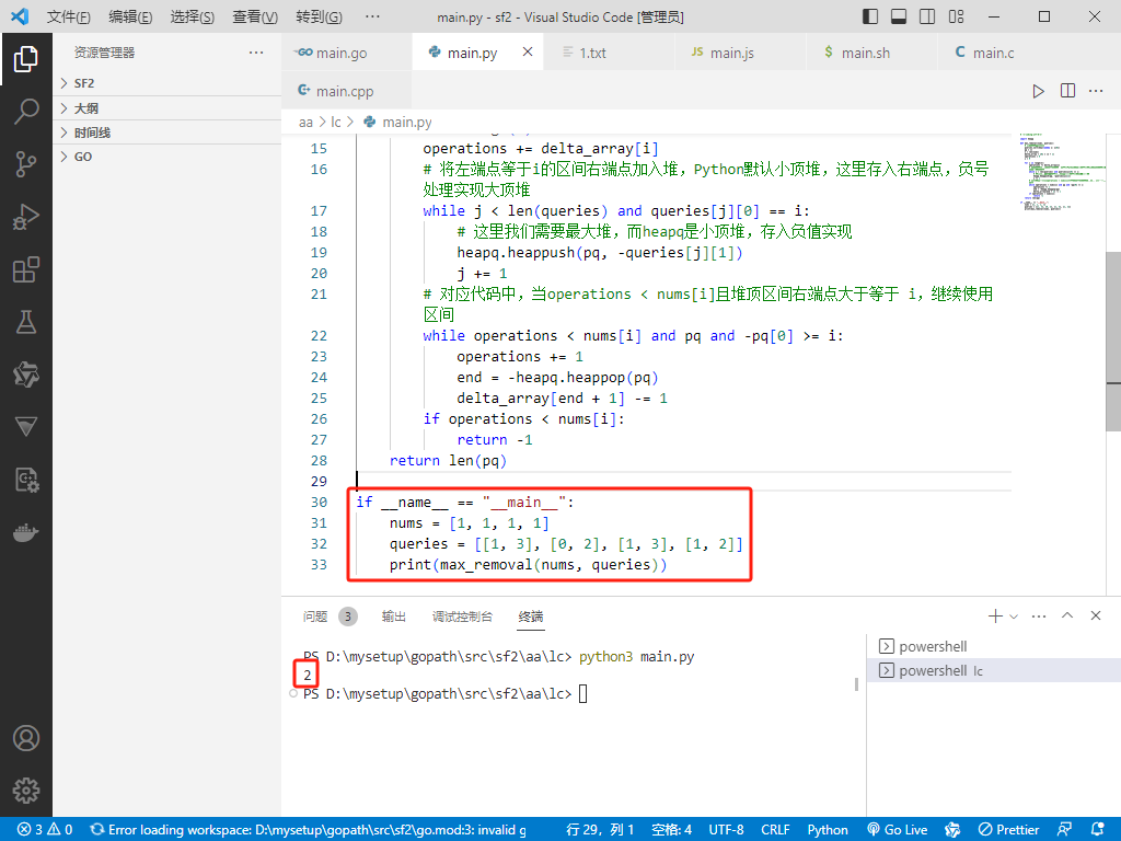

Python完整代码如下:
# -*-coding:utf-8-*-
import heapq
def max_removal(nums, queries):
    # 按左端点升序排序
    queries.sort(key=lambda x: x[0])
    pq = []
    n = len(nums)
    delta_array = [0] * (n + 1)
    operations = 0
    j = 0
    for i in range(n):
        operations += delta_array[i]
        # 将左端点等于i的区间右端点加入堆,Python默认小顶堆,这里存入右端点,负号处理实现大顶堆
        while j < len(queries) and queries[j][0] == i:
            # 这里我们需要最大堆,而heapq是小顶堆,存入负值实现
            heapq.heappush(pq, -queries[j][1])
            j += 1
        # 对应代码中,当operations < nums[i]且堆顶区间右端点大于等于 i,继续使用区间
        while operations < nums[i] and pq and -pq[0] >= i:
            operations += 1
            end = -heapq.heappop(pq)
            delta_array[end + 1] -= 1
        if operations < nums[i]:
            return -1
    return len(pq)
if __name__ == "__main__":
    nums = [1, 1, 1, 1]
    queries = [[1, 3], [0, 2], [1, 3], [1, 2]]
    print(max_removal(nums, queries))
