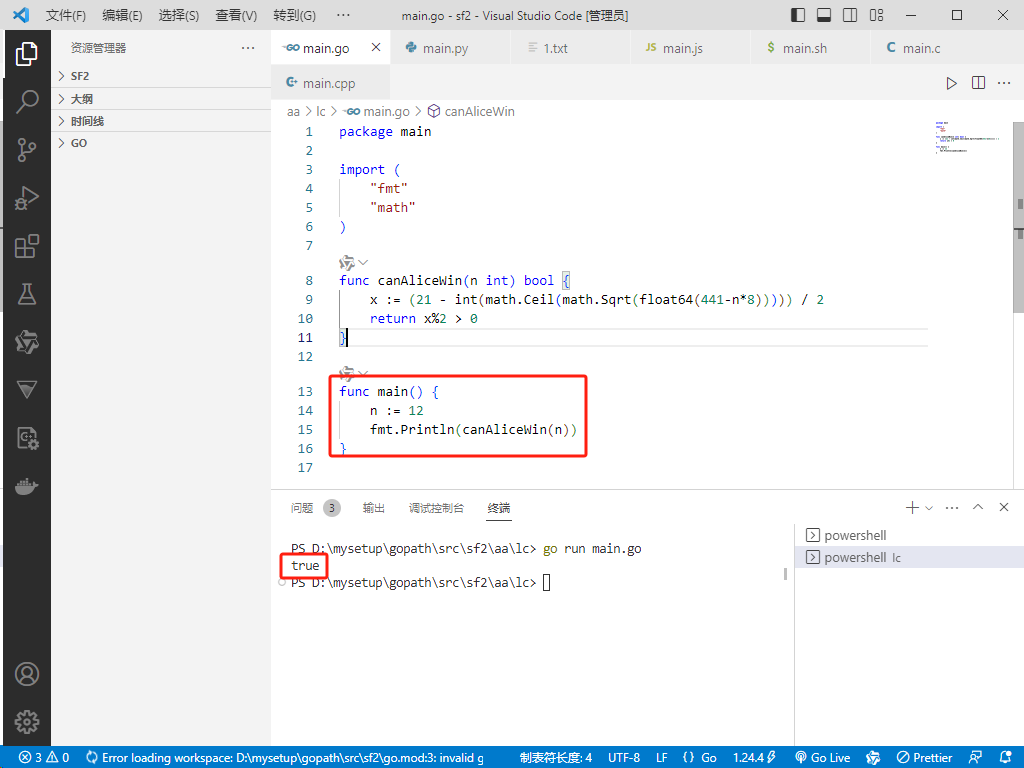

Go完整代码如下:
package main
import (
	"fmt"
	"math"
func canAliceWin(n int) bool {
	x := (21 - int(math.Ceil(math.Sqrt(float64(441-n*8))))) / 2
	return x%2 > 0
func main() {
	n := 12
	fmt.Println(canAliceWin(n))

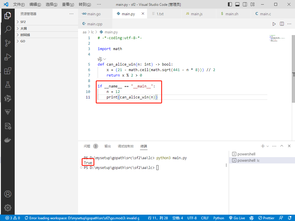

Python完整代码如下:
# -*-coding:utf-8-*-
import math
def can_alice_win(n: int) -> bool:
    x = (21 - math.ceil(math.sqrt(441 - n * 8))) // 2
    return x % 2 > 0
if __name__ == "__main__":
    n = 12
    print(can_alice_win(n))
