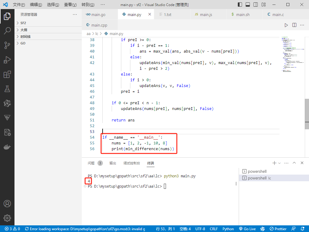

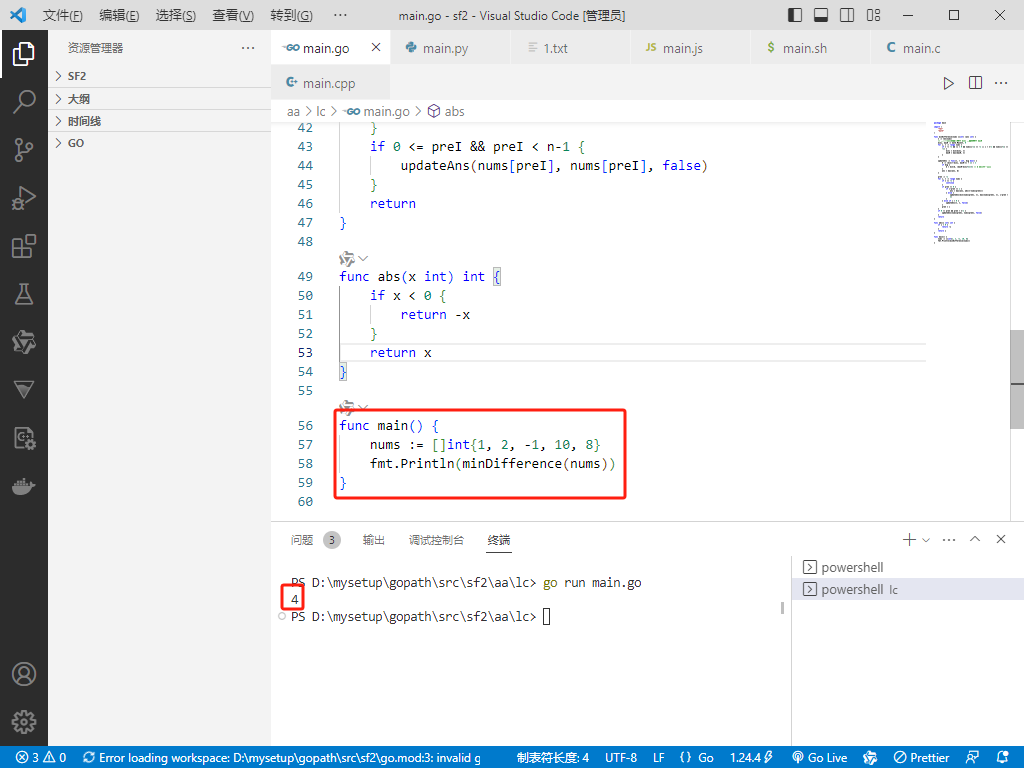

func main() {
	nums := []int{1, 2, -1, 10, 8}
	fmt.Println(minDifference(nums))

if __name__ == '__main__':
    nums = [1, 2, -1, 10, 8]
    print(min_difference(nums))
