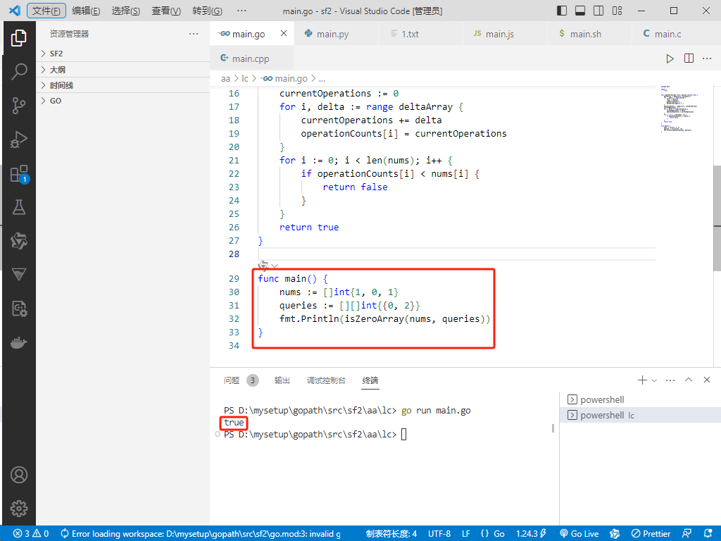

Go完整代码如下:
package main
import (
	"fmt"
func isZeroArray(nums []int, queries [][]int) bool {
	deltaArray := make([]int, len(nums)+1)
	for _, query := range queries {
		left := query[0]
		right := query[1]
		deltaArray[left] += 1
		deltaArray[right+1] -= 1
	operationCounts := make([]int, len(deltaArray))
	currentOperations := 0
	for i, delta := range deltaArray {
		currentOperations += delta
		operationCounts[i] = currentOperations
	for i := 0; i < len(nums); i++ {
		if operationCounts[i] < nums[i] {
			return false
	return true
func main() {
	nums := []int{1, 0, 1}
	queries := [][]int{{0, 2}}
	fmt.Println(isZeroArray(nums, queries))

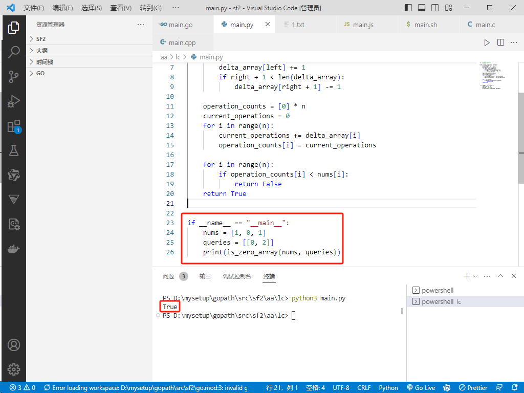

Python完整代码如下:
# -*-coding:utf-8-*-
def is_zero_array(nums, queries):
    n = len(nums)
    delta_array = [0] * (n + 1)
    for left, right in queries:
        delta_array[left] += 1
        if right + 1 < len(delta_array):
            delta_array[right + 1] -= 1
    operation_counts = [0] * n
    current_operations = 0
    for i in range(n):
        current_operations += delta_array[i]
        operation_counts[i] = current_operations
    for i in range(n):
        if operation_counts[i] < nums[i]:
            return False
    return True
if __name__ == "__main__":
    nums = [1, 0, 1]
    queries = [[0, 2]]
    print(is_zero_array(nums, queries))
