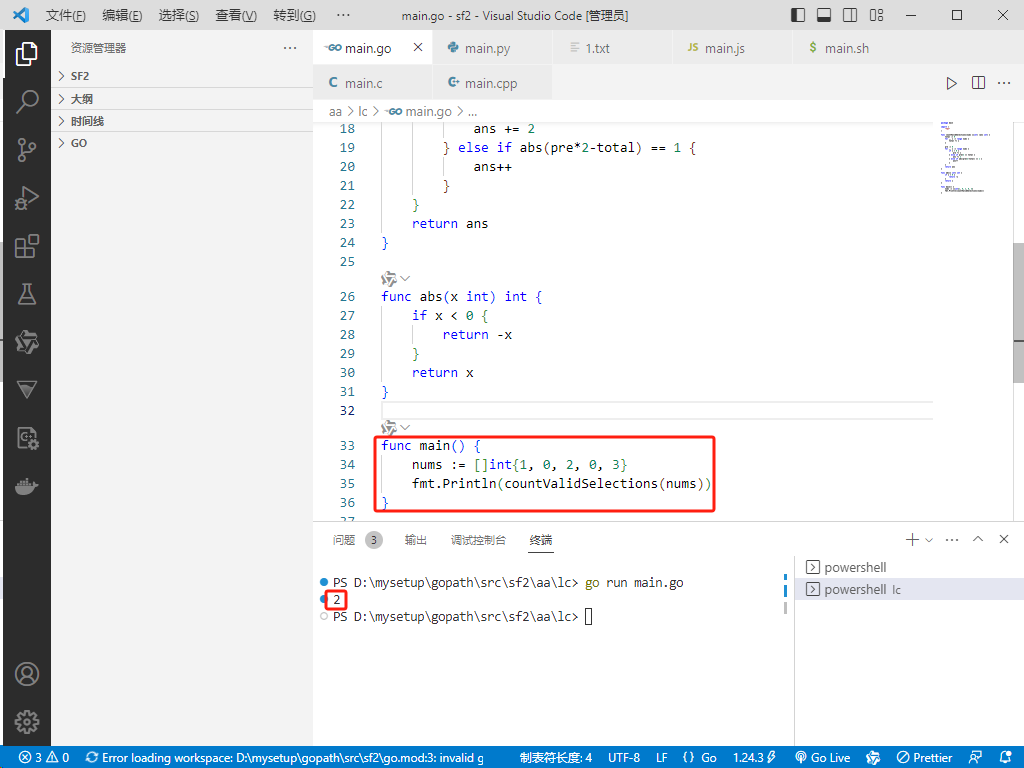

Go完整代码如下:
package main
import (
	"fmt"
func countValidSelections(nums []int) (ans int) {
	total := 0
	for _, x := range nums {
		total += x
	pre := 0
		if x > 0 {
			pre += x
		} else if pre*2 == total {
			ans += 2
		} else if abs(pre*2-total) == 1 {
			ans++
	return ans
func abs(x int) int {
	if x < 0 {
		return -x
	return x
func main() {
	nums := []int{1, 0, 2, 0, 3}
	fmt.Println(countValidSelections(nums))

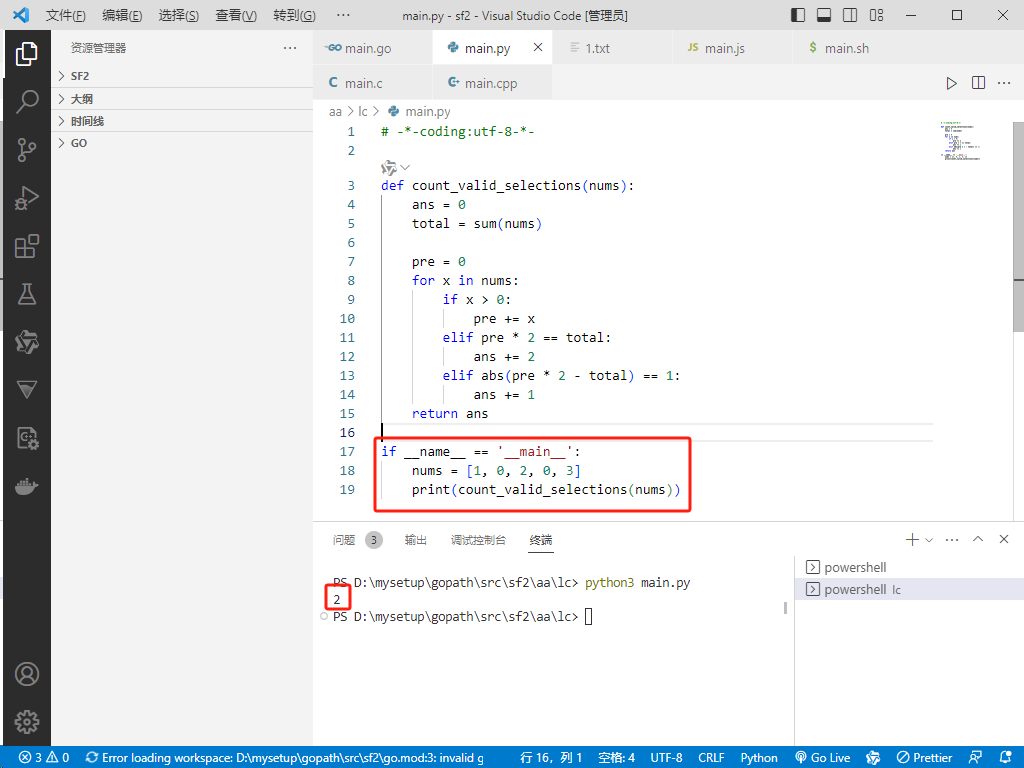

Python完整代码如下:
# -*-coding:utf-8-*-
def count_valid_selections(nums):
    ans = 0
    total = sum(nums)
    pre = 0
    for x in nums:
        if x > 0:
            pre += x
        elif pre * 2 == total:
            ans += 2
        elif abs(pre * 2 - total) == 1:
            ans += 1
    return ans
if __name__ == '__main__':
    nums = [1, 0, 2, 0, 3]
    print(count_valid_selections(nums))
