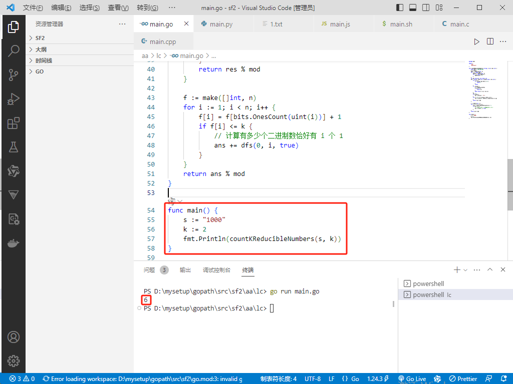

func main() {
	s := "1000"
	k := 2
	fmt.Println(countKReducibleNumbers(s, k))
