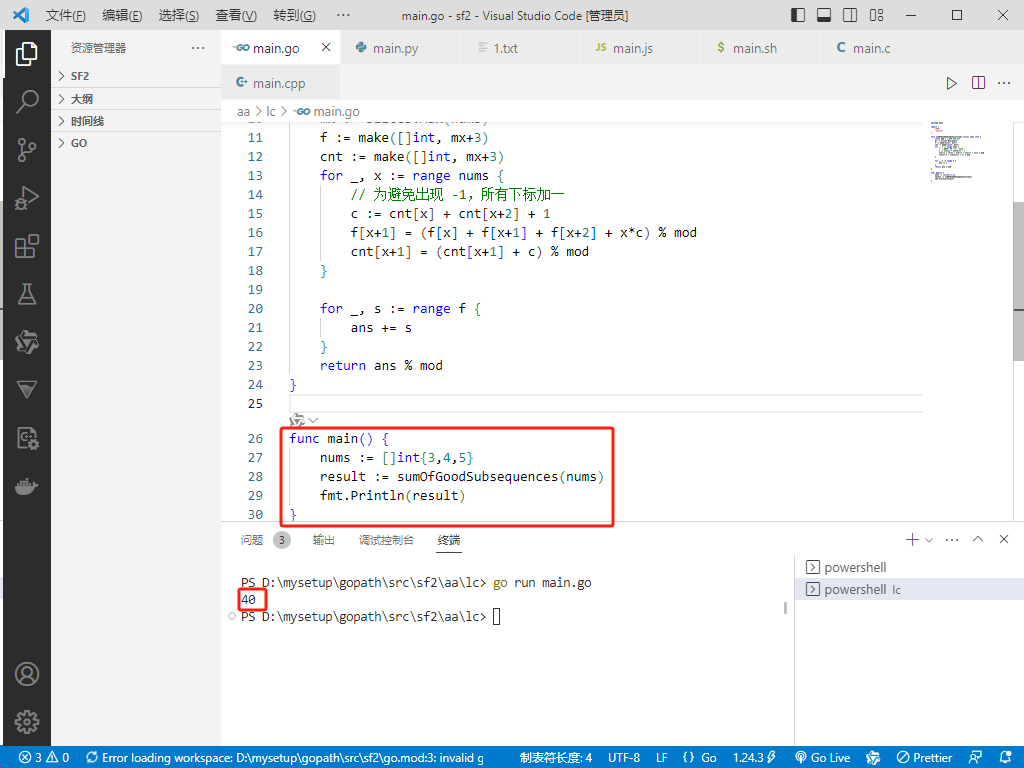

Go完整代码如下:
package main
import (
"fmt"
"slices"
func sumOfGoodSubsequences(nums []int) (ans int) {
const mod = 1_000_000_007
mx := slices.Max(nums)
f := make([]int, mx+3)
cnt := make([]int, mx+3)
for _, x := range nums {
// 为避免出现 -1,所有下标加一
c := cnt[x] + cnt[x+2] + 1
f[x+1] = (f[x] + f[x+1] + f[x+2] + x*c) % mod
cnt[x+1] = (cnt[x+1] + c) % mod
for _, s := range f {
ans += s
return ans % mod
func main() {
nums := []int{3,4,5}
result := sumOfGoodSubsequences(nums)
fmt.Println(result)

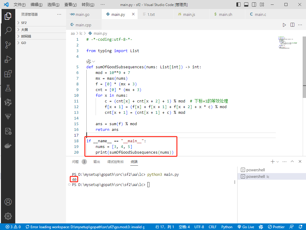

Python完整代码如下:
# -*-coding:utf-8-*-
from typing import List
def sumOfGoodSubsequences(nums: List[int]) -> int:
mod = 10**9 + 7
mx = max(nums)
f = [0] * (mx + 3)
cnt = [0] * (mx + 3)
for x in nums:
c = (cnt[x] + cnt[x + 2] + 1) % mod # 下标+1的等效处理
f[x + 1] = (f[x] + f[x + 1] + f[x + 2] + x * c) % mod
cnt[x + 1] = (cnt[x + 1] + c) % mod
ans = sum(f) % mod
return ans
if __name__ == "__main__":
nums = [3, 4, 5]
print(sumOfGoodSubsequences(nums))
