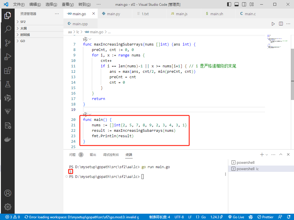

Go完整代码如下:
package main
import (
	"fmt"
func maxIncreasingSubarrays(nums []int) (ans int) {
	preCnt, cnt := 0, 0
	for i, x := range nums {
		cnt++
		if i == len(nums)-1 || x >= nums[i+1] { // i 是严格递增段的末尾
			ans = max(ans, cnt/2, min(preCnt, cnt))
			preCnt = cnt
			cnt = 0
	return
func main() {
	nums := []int{2, 5, 7, 8, 9, 2, 3, 4, 3, 1}
	result := maxIncreasingSubarrays(nums)
	fmt.Println(result)

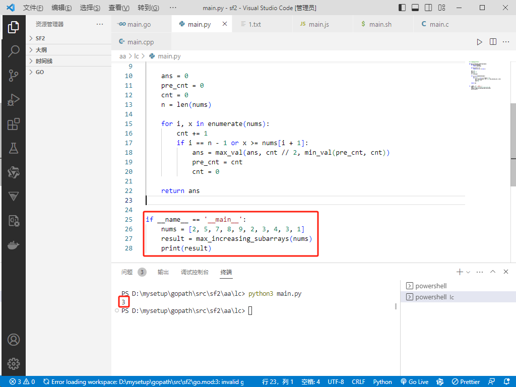

Python完整代码如下:
# -*-coding:utf-8-*-
def max_increasing_subarrays(nums):
    def max_val(*args):
        return max(args)
    def min_val(a, b):
        return a if a < b else b
    ans = 0
    pre_cnt = 0
    cnt = 0
    n = len(nums)
    for i, x in enumerate(nums):
        cnt += 1
        if i == n - 1 or x >= nums[i + 1]:
            ans = max_val(ans, cnt // 2, min_val(pre_cnt, cnt))
            pre_cnt = cnt
            cnt = 0
    return ans
if __name__ == '__main__':
    nums = [2, 5, 7, 8, 9, 2, 3, 4, 3, 1]
    result = max_increasing_subarrays(nums)
    print(result)
