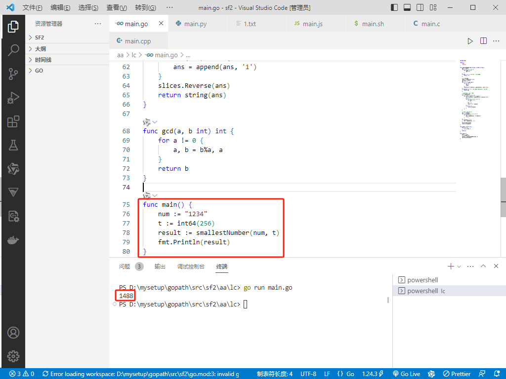

func main() {
	num := "1234"
	t := int64(256)
	result := smallestNumber(num, t)
	fmt.Println(result)
