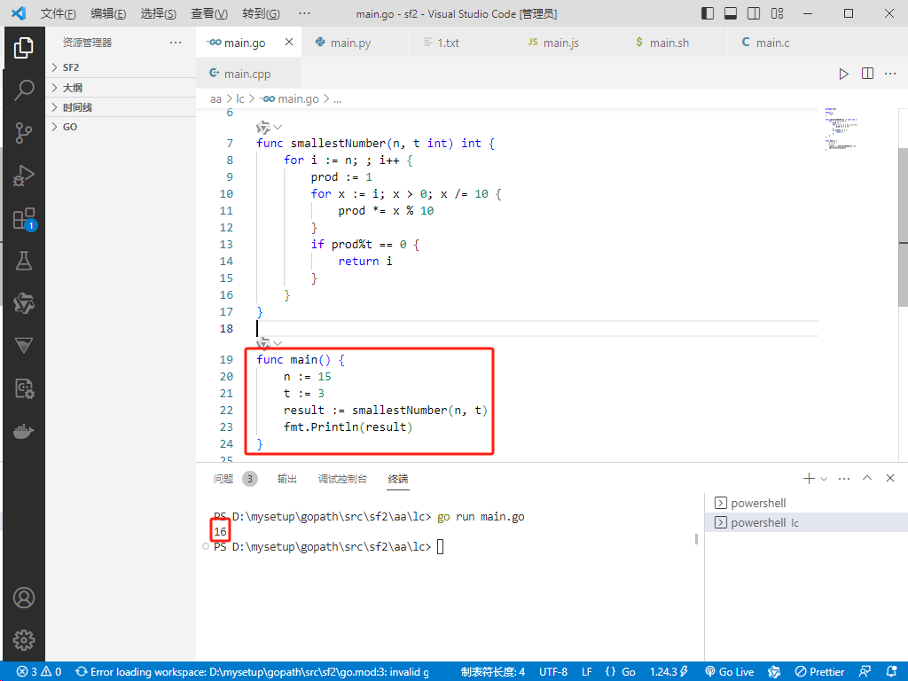

Go完整代码如下:
package main
import (
	"fmt"
func smallestNumber(n, t int) int {
	for i := n; ; i++ {
		prod := 1
		for x := i; x > 0; x /= 10 {
			prod *= x % 10
		if prod%t == 0 {
			return i
func main() {
	n := 15
	t := 3
	result := smallestNumber(n, t)
	fmt.Println(result)

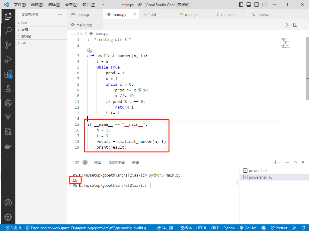

Python完整代码如下:
# -*-coding:utf-8-*-
def smallest_number(n, t):
    i = n
    while True:
        prod = 1
        x = i
        while x > 0:
            prod *= x % 10
            x //= 10
        if prod % t == 0:
            return i
        i += 1
if __name__ == "__main__":
    n = 15
    t = 3
    result = smallest_number(n, t)
    print(result)
