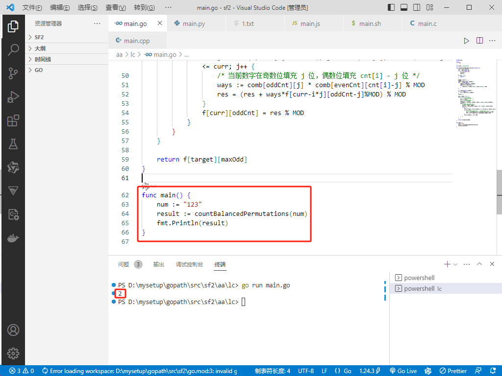

Go完整代码如下:
package main
import (
	"fmt"
const MOD = 1_000_000_007
func countBalancedPermutations(num string) int {
	tot, n := 0, len(num)
	cnt := make([]int, 10)
	for _, ch := range num {
		d := int(ch - '0')
		cnt[d]++
		tot += d
	if tot%2 != 0 {
		return 0
	target := tot / 2
	maxOdd := (n + 1) / 2
	comb := make([][]int, maxOdd+1)
	for i := range comb {
		comb[i] = make([]int, maxOdd+1)
		comb[i][i], comb[i][0] = 1, 1
		for j := 1; j < i; j++ {
			comb[i][j] = (comb[i-1][j] + comb[i-1][j-1]) % MOD
	f := make([][]int, target+1)
	for i := range f {
		f[i] = make([]int, maxOdd+1)
	f[0][0] = 1
	psum, totSum := 0, 0
	for i := 0; i <= 9; i++ {
		/* 前 i 个数字的数目之和 */
		psum += cnt[i]
		/* 前 i 个数字的元素之和 */
		totSum += i * cnt[i]
		for oddCnt := min(psum, maxOdd); oddCnt >= max(0, psum-(n-maxOdd)); oddCnt-- {
			/* 偶数位需要填充的位数 */
			evenCnt := psum - oddCnt
			for curr := min(totSum, target); curr >= max(0, totSum-target); curr-- {
				res := 0
				for j := max(0, cnt[i]-evenCnt); j <= min(cnt[i], oddCnt) && i*j <= curr; j++ {
					/* 当前数字在奇数位填充 j 位,偶数位填充 cnt[i] - j 位 */
					ways := comb[oddCnt][j] * comb[evenCnt][cnt[i]-j] % MOD
					res = (res + ways*f[curr-i*j][oddCnt-j]%MOD) % MOD
				f[curr][oddCnt] = res % MOD
	return f[target][maxOdd]
func main() {
	num := "123"
	result := countBalancedPermutations(num)
	fmt.Println(result)

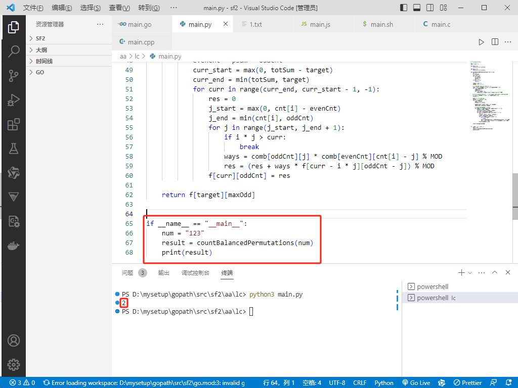

Python完整代码如下:
# -*-coding:utf-8-*-
MOD = 10**9 + 7
def min(a, b):
    return a if a < b else b
def max(a, b):
    return a if a > b else b
def countBalancedPermutations(num: str) -> int:
    tot = 0
    n = len(num)
    cnt = [0] * 10
    for ch in num:
        d = int(ch)
        cnt[d] += 1
        tot += d
    if tot % 2 != 0:
        return 0
    target = tot // 2
    maxOdd = (n + 1) // 2
    # 计算组合数 comb[i][j] 表示 C(i, j)
    comb = [[0] * (maxOdd + 1) for _ in range(maxOdd + 1)]
    for i in range(maxOdd + 1):
        comb[i][0] = 1
        comb[i][i] = 1
        for j in range(1, i):
    # f[curr][oddCnt] 表示当前和为 curr,奇数位填充 oddCnt 个数字的方案数
    f = [[0] * (maxOdd + 1) for _ in range(target + 1)]
    f[0][0] = 1
    psum = 0  # cnt 的前缀和
    totSum = 0  # 数字之和前缀和
    for i in range(10):
        psum += cnt[i]
        oddCnt_start = max(0, psum - (n - maxOdd))
        oddCnt_end = min(psum, maxOdd)
        # 从大到小遍历避免重复计算覆盖
        for oddCnt in range(oddCnt_end, oddCnt_start - 1, -1):
            evenCnt = psum - oddCnt
            curr_start = max(0, totSum - target)
            curr_end = min(totSum, target)
            for curr in range(curr_end, curr_start - 1, -1):
                res = 0
                j_start = max(0, cnt[i] - evenCnt)
                j_end = min(cnt[i], oddCnt)
                for j in range(j_start, j_end + 1):
                    if i * j > curr:
                        break
                    ways = comb[oddCnt][j] * comb[evenCnt][cnt[i] - j] % MOD
                    res = (res + ways * f[curr - i * j][oddCnt - j]) % MOD
if __name__ == "__main__":
    num = "123"
    result = countBalancedPermutations(num)
    print(result)
