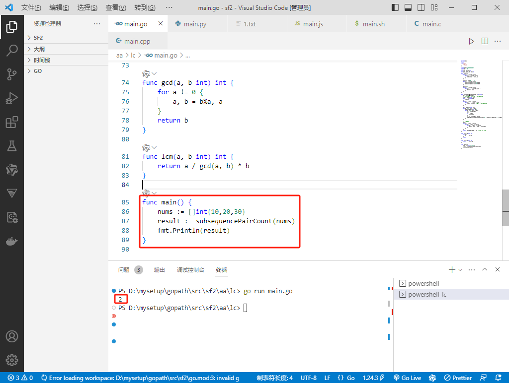

func main() {
	nums := []int{10,20,30}
	result := subsequencePairCount(nums)
	fmt.Println(result)
