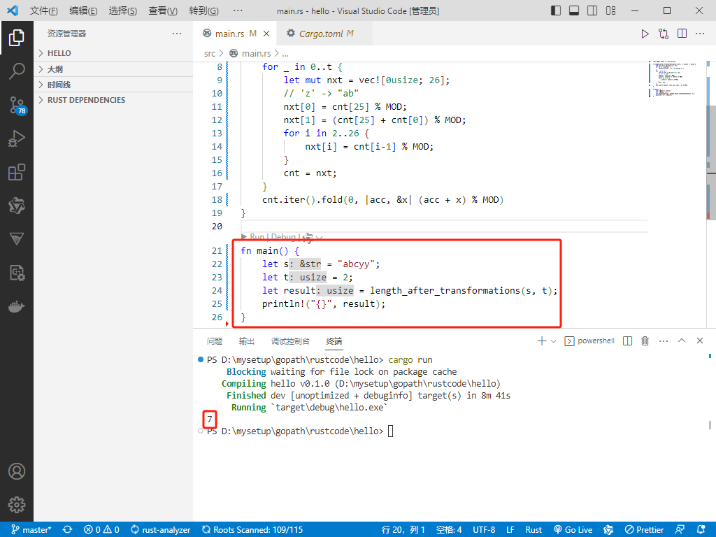

Rust完整代码如下:
const MOD: usize = 1_000_000_007;
fn length_after_transformations(s: &str, t: usize) -> usize {
    let mut cnt = vec![0usize; 26];
    for ch in s.chars() {
        cnt[(ch as u8 - b'a') as usize] += 1;
    for _ in 0..t {
        let mut nxt = vec![0usize; 26];
        // 'z' -> "ab"
        nxt[0] = cnt[25] % MOD;
        nxt[1] = (cnt[25] + cnt[0]) % MOD;
        for i in 2..26 {
            nxt[i] = cnt[i-1] % MOD;
        cnt = nxt;
    cnt.iter().fold(0, |acc, &x| (acc + x) % MOD)
fn main() {
    let s = "abcyy";
    let t = 2;
    let result = length_after_transformations(s, t);
    println!("{}", result);

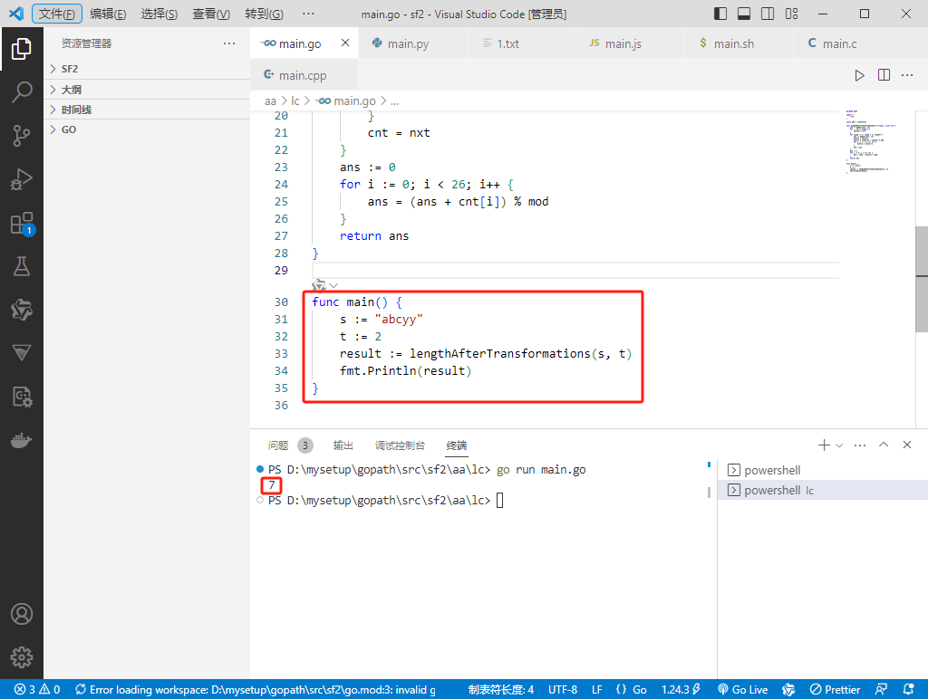

Go完整代码如下:
package main
import (
	"fmt"
const mod = 1000000007
func lengthAfterTransformations(s string, t int) int {
	cnt := make([]int, 26)
	for _, ch := range s {
		cnt[ch-'a']++
	for round := 0; round < t; round++ {
		nxt := make([]int, 26)
		nxt[0] = cnt[25]
		nxt[1] = (cnt[25] + cnt[0]) % mod
		for i := 2; i < 26; i++ {
			nxt[i] = cnt[i-1]
		cnt = nxt
	ans := 0
	for i := 0; i < 26; i++ {
		ans = (ans + cnt[i]) % mod
	return ans
func main() {
	s := "abcyy"
	t := 2
	result := lengthAfterTransformations(s, t)
	fmt.Println(result)
