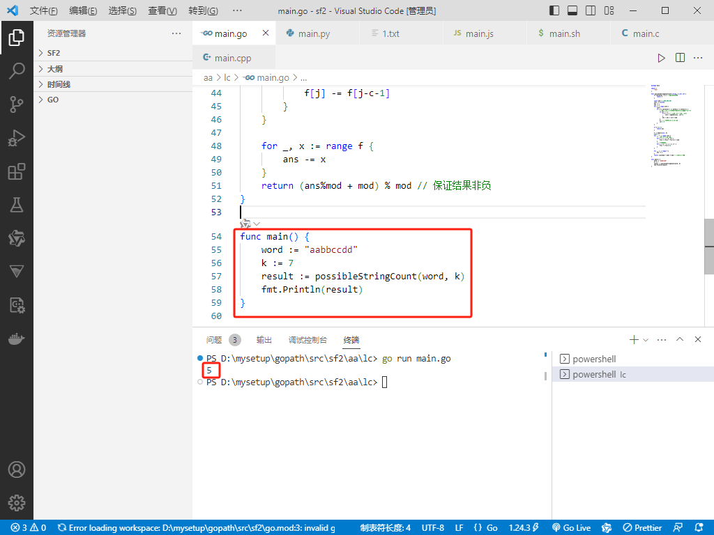

Go完整代码如下:
package main
import (
	"fmt"
func possibleStringCount(word string, k int) int {
	if len(word) < k { // 无法满足要求
		return 0
	const mod = 1_000_000_007
	cnts := []int{}
	ans := 1
	cnt := 0
	for i := range word {
		cnt++
		if i == len(word)-1 || word[i] != word[i+1] {
			// 如果 cnt = 1,这组字符串必选,无需参与计算
			if cnt > 1 {
				if k > 0 { // 保证空间复杂度为 O(k)
					cnts = append(cnts, cnt-1)
				ans = ans * cnt % mod
			k-- // 注意这里把 k 减小了
			cnt = 0
	if k <= 0 {
		return ans
	f := make([]int, k)
	f[0] = 1
	for _, c := range cnts {
		// 原地计算 f 的前缀和
		for j := 1; j < k; j++ {
			f[j] = (f[j] + f[j-1]) % mod
		// 计算子数组和
		for j := k - 1; j > c; j-- {
			f[j] -= f[j-c-1]
	for _, x := range f {
		ans -= x
	return (ans%mod + mod) % mod // 保证结果非负
func main() {
	word := "aabbccdd"
	k := 7
	result := possibleStringCount(word, k)
	fmt.Println(result)

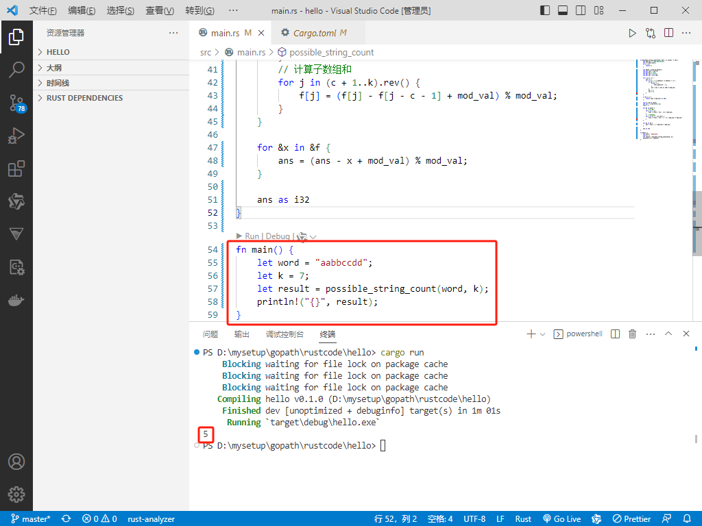

Rust完整代码如下:
fn possible_string_count(word: &str, k: usize) -> i32 {
    let mod_val = 1_000_000_007i64;
    let n = word.len();
    if n < k {
        return 0;
    let bytes = word.as_bytes();
    let mut cnts = vec![];
    let mut ans = 1i64;
    let mut cnt = 0usize;
    let mut kk = k as i32;
    for i in 0..n {
        cnt += 1;
        if i == n - 1 || bytes[i] != bytes[i + 1] {
            if cnt > 1 {
                if kk > 0 {
                    cnts.push(cnt - 1);
                ans = ans * (cnt as i64) % mod_val;
            kk -= 1;
            cnt = 0;
    if kk <= 0 {
        return (ans % mod_val) as i32;
    let k = kk as usize;
    let mut f = vec![0i64; k];
    f[0] = 1;
    for &c in &cnts {
        // 计算前缀和
        for j in 1..k {
            f[j] = (f[j] + f[j - 1]) % mod_val;
        // 计算子数组和
        for j in (c + 1..k).rev() {
            f[j] = (f[j] - f[j - c - 1] + mod_val) % mod_val;
    for &x in &f {
        ans = (ans - x + mod_val) % mod_val;
    ans as i32
fn main() {
    let word = "aabbccdd";
    let k = 7;
    let result = possible_string_count(word, k);
    println!("{}", result);
