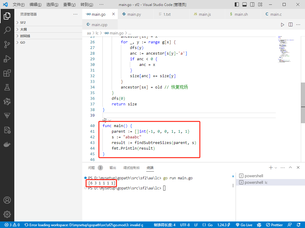

Go完整代码如下:
package main
import (
	"fmt"
func findSubtreeSizes(parent []int, s string) []int {
	n := len(parent)
	g := make([][]int, n)
	for i := 1; i < n; i++ {
		p := parent[i]
		g[p] = append(g[p], i)
	size := make([]int, n)
	ancestor := [26]int{}
	for i := range ancestor {
		ancestor[i] = -1
	var dfs func(int)
	dfs = func(x int) {
		size[x] = 1
		sx := s[x] - 'a'
		old := ancestor[sx]
		ancestor[sx] = x
		for _, y := range g[x] {
			dfs(y)
			anc := ancestor[s[y]-'a']
			if anc < 0 {
				anc = x
			size[anc] += size[y]
		ancestor[sx] = old // 恢复现场
	dfs(0)
	return size
func main() {
	parent := []int{-1, 0, 0, 1, 1, 1}
	s := "abaabc"
	result := findSubtreeSizes(parent, s)
	fmt.Println(result)

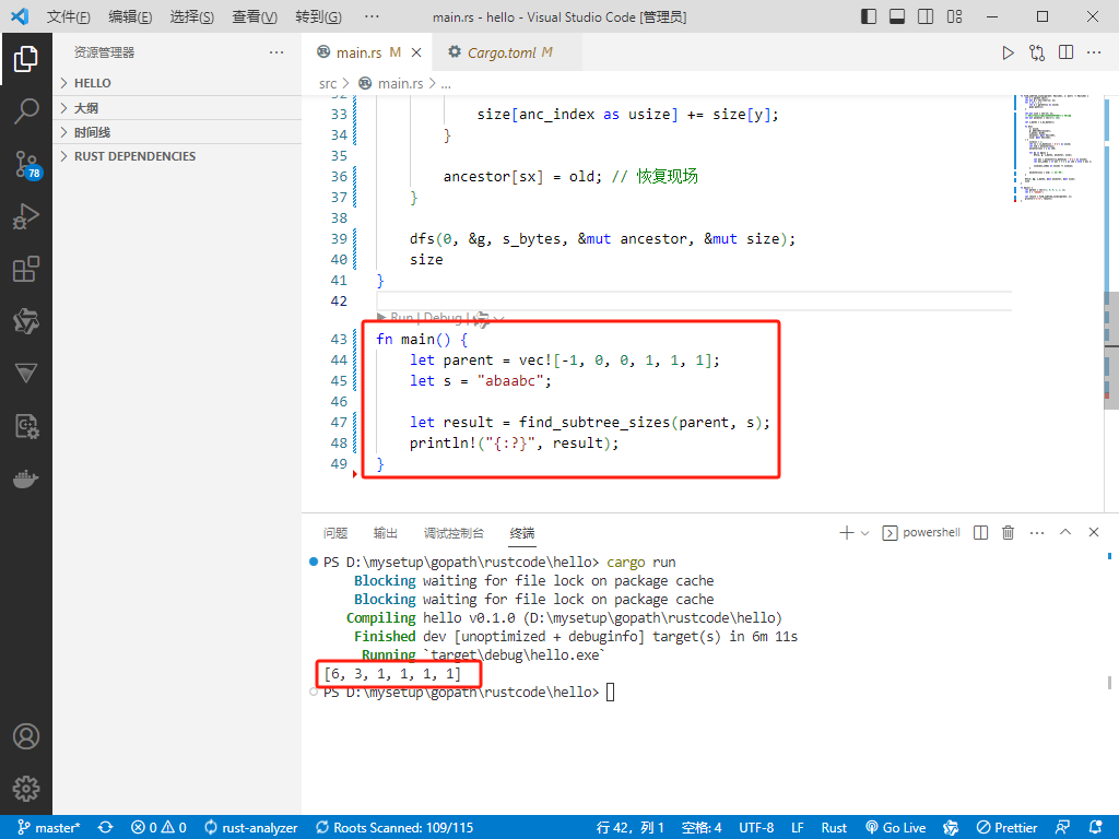

Rust完整代码如下:
fn find_subtree_sizes(parent: Vec<i32>, s: &str) -> Vec<i32> {
    let n = parent.len();
    let mut g = vec![vec![]; n];
    for i in 1..n {
        let p = parent[i] as usize;
        g[p].push(i);
    let mut size = vec![0; n];
    // 记录字符对应最近祖先节点编号,-1 表示无
    let mut ancestor = vec![-1; 26];
    let s_bytes = s.as_bytes();
    fn dfs(
        x: usize,
        g: &Vec<Vec<usize>>,
        s_bytes: &[u8],
        ancestor: &mut Vec<i32>,
        size: &mut Vec<i32>,
        size[x] = 1;
        let sx = (s_bytes[x] - b'a') as usize;
        let old = ancestor[sx];
        ancestor[sx] = x as i32;
        for &y in &g[x] {
            dfs(y, g, s_bytes, ancestor, size);
            let anc = ancestor[(s_bytes[y] - b'a') as usize];
            let anc_index = if anc < 0 { x as i32 } else { anc };
            size[anc_index as usize] += size[y];
        ancestor[sx] = old; // 恢复现场
    dfs(0, &g, s_bytes, &mut ancestor, &mut size);
    size
fn main() {
    let parent = vec![-1, 0, 0, 1, 1, 1];
    let s = "abaabc";
    let result = find_subtree_sizes(parent, s);
    println!("{:?}", result);
