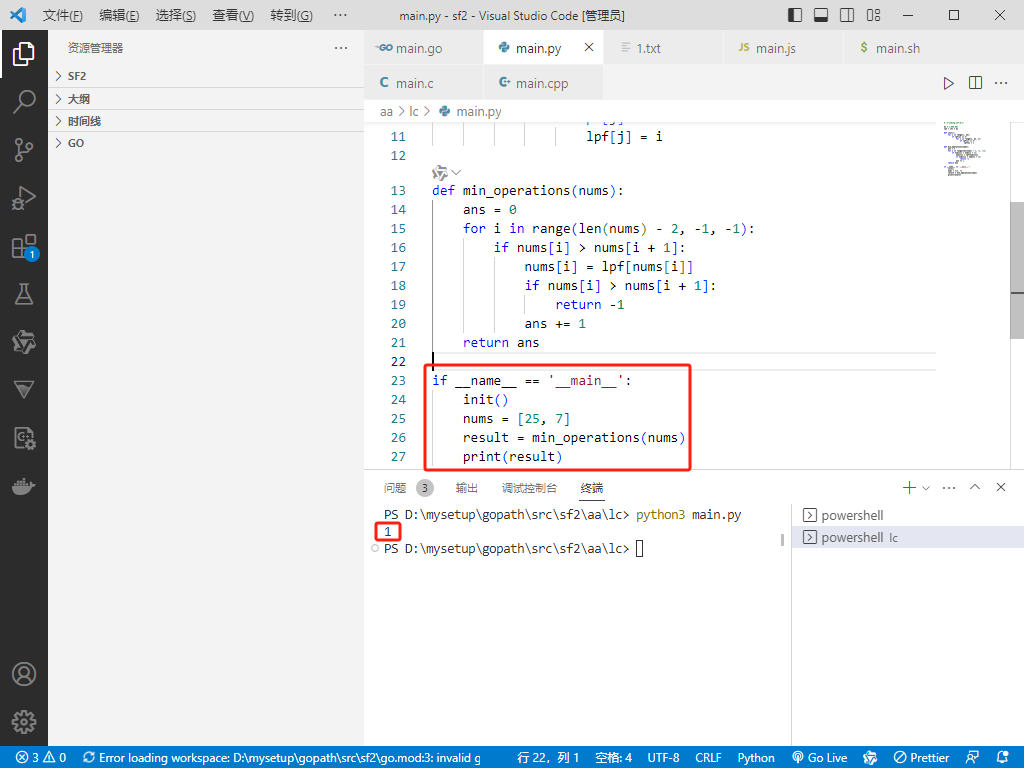

Python完整代码如下:
# -*-coding:utf-8-*-
mx = 1_000_001
lpf = [0] * mx
def init():
for i in range(2, mx):
if lpf[i] == 0:
for j in range(i, mx, i):
if lpf[j] == 0:
lpf[j] = i
def min_operations(nums):
ans = 0
for i in range(len(nums) - 2, -1, -1):
if nums[i] > nums[i + 1]:
nums[i] = lpf[nums[i]]
return -1
ans += 1
return ans
if __name__ == '__main__':
init()
nums = [25, 7]
result = min_operations(nums)
print(result)

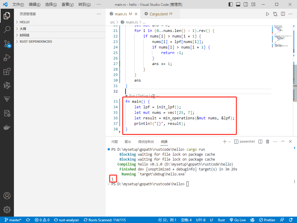

Rust完整代码如下:
const MX: usize = 1_000_001;
fn init_lpf() -> Vec<usize> {
let mut lpf = vec![0; MX];
for i in 2..MX {
if lpf[i] == 0 {
let mut j = i;
while j < MX {
if lpf[j] == 0 {
lpf[j] = i;
j += i;
lpf
fn min_operations(nums: &mut [usize], lpf: &[usize]) -> i32 {
let mut ans = 0;
for i in (0..nums.len() - 1).rev() {
if nums[i] > nums[i + 1] {
nums[i] = lpf[nums[i]];
return -1;
ans += 1;
ans
fn main() {
let lpf = init_lpf();
let mut nums = vec![25, 7];
let result = min_operations(&mut nums, &lpf);
println!("{}", result);
