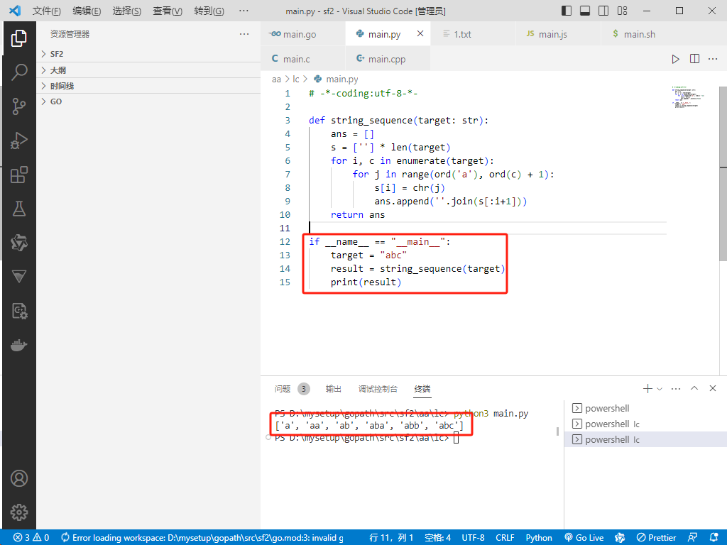

Python完整代码如下:
# -*-coding:utf-8-*-
def string_sequence(target: str):
    ans = []
    s = [''] * len(target)
    for i, c in enumerate(target):
        for j in range(ord('a'), ord(c) + 1):
            s[i] = chr(j)
            ans.append(''.join(s[:i+1]))
    return ans
if __name__ == "__main__":
    target = "abc"
    result = string_sequence(target)
    print(result)
