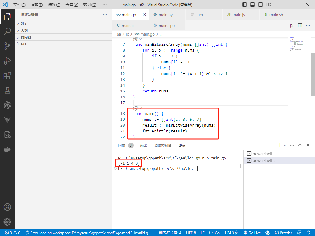

Go完整代码如下:
package main
import (
	"fmt"
func minBitwiseArray(nums []int) []int {
	for i, x := range nums {
		if x == 2 {
			nums[i] = -1
		} else {
			nums[i] ^= (x + 1) &^ x >> 1
	return nums
func main() {
	nums := []int{2, 3, 5, 7}
	result := minBitwiseArray(nums)
	fmt.Println(result)
Python完整代码如下:
# -*-coding:utf-8-*-
from typing import List
def min_bitwise_array(nums: List[int]) -> List[int]:
    for i, x in enumerate(nums):
        if x == 2:
            nums[i] = -1
        else:
            nums[i] = x ^ (((x + 1) & (~x)) >> 1)
    return nums
if __name__ == "__main__":
    nums = [2, 3, 5, 7]
    result = min_bitwise_array(nums)
    print(result)
