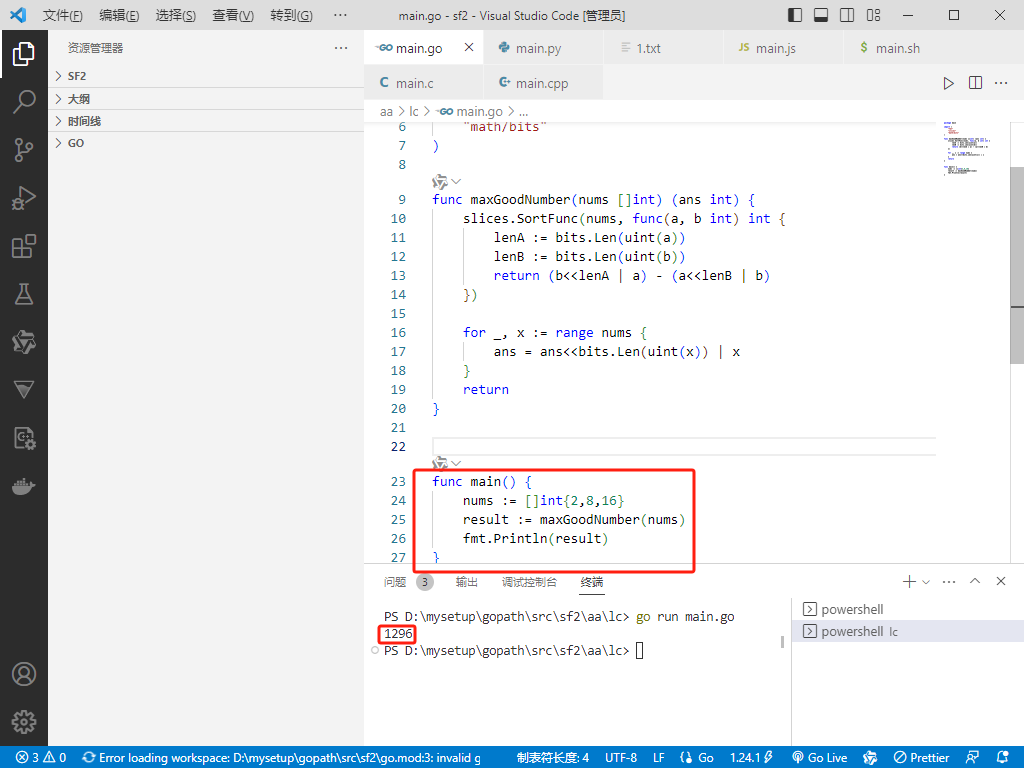

Go完整代码如下:
package main
import (
	"fmt"
	"slices"
	"math/bits"
func maxGoodNumber(nums []int) (ans int) {
	slices.SortFunc(nums, func(a, b int) int {
		lenA := bits.Len(uint(a))
		lenB := bits.Len(uint(b))
		return (b<<lenA | a) - (a<<lenB | b)
	for _, x := range nums {
		ans = ans<<bits.Len(uint(x)) | x
	return
func main() {
	nums := []int{2,8,16}
	result := maxGoodNumber(nums)
	fmt.Println(result)

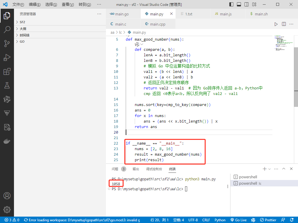

Python完整代码如下:
# -*-coding:utf-8-*-
from functools import cmp_to_key
def max_good_number(nums):
    def compare(a, b):
        lenA = a.bit_length()
        lenB = b.bit_length()
        # 模拟 Go 中位运算构造的比较方式
        val1 = (b << lenA) | a
        val2 = (a << lenB) | b
        # 返回正负决定排序顺序
        return val2 - val1  # 因为 Go排序传入返回 a-b,Python中 cmp 返回 <0表示a<b,所以反向用了 val2 - val1
    nums.sort(key=cmp_to_key(compare))
    ans = 0
    for x in nums:
        ans = (ans << x.bit_length()) | x
    return ans
if __name__ == "__main__":
    nums = [2, 8, 16]
    result = max_good_number(nums)
    print(result)
