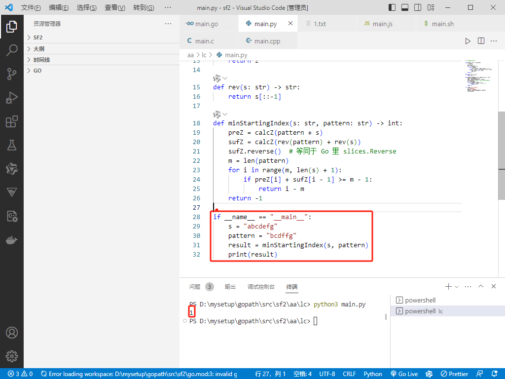

Python3完整代码如下:
# -*-coding:utf-8-*-
def calcZ(s: str) -> list[int]:
n = len(s)
z = [0] * n
boxL, boxR = 0, 0
for i in range(1, n):
if i <= boxR:
z[i] = min(z[i - boxL], boxR - i + 1)
while i + z[i] < n and s[z[i]] == s[i + z[i]]:
boxL, boxR = i, i + z[i]
z[i] += 1
return z
def rev(s: str) -> str:
return s[::-1]
def minStartingIndex(s: str, pattern: str) -> int:
preZ = calcZ(pattern + s)
sufZ = calcZ(rev(pattern) + rev(s))
sufZ.reverse() # 等同于 Go 里 slices.Reverse
m = len(pattern)
for i in range(m, len(s) + 1):
if preZ[i] + sufZ[i - 1] >= m - 1:
return i - m
return -1
if __name__ == "__main__":
s = "abcdefg"
pattern = "bcdffg"
result = minStartingIndex(s, pattern)
print(result)
