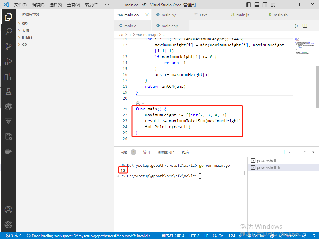

Go完整代码如下:
package main
import (
	"fmt"
	"slices"
func maximumTotalSum(maximumHeight []int) int64 {
	slices.SortFunc(maximumHeight, func(a, b int) int { return b - a })
	ans := maximumHeight[0]
	for i := 1; i < len(maximumHeight); i++ {
		maximumHeight[i] = min(maximumHeight[i], maximumHeight[i-1]-1)
		if maximumHeight[i] <= 0 {
			return -1
		ans += maximumHeight[i]
	return int64(ans)
func main() {
	maximumHeight := []int{2, 3, 4, 3}
	result := maximumTotalSum(maximumHeight)
	fmt.Println(result)

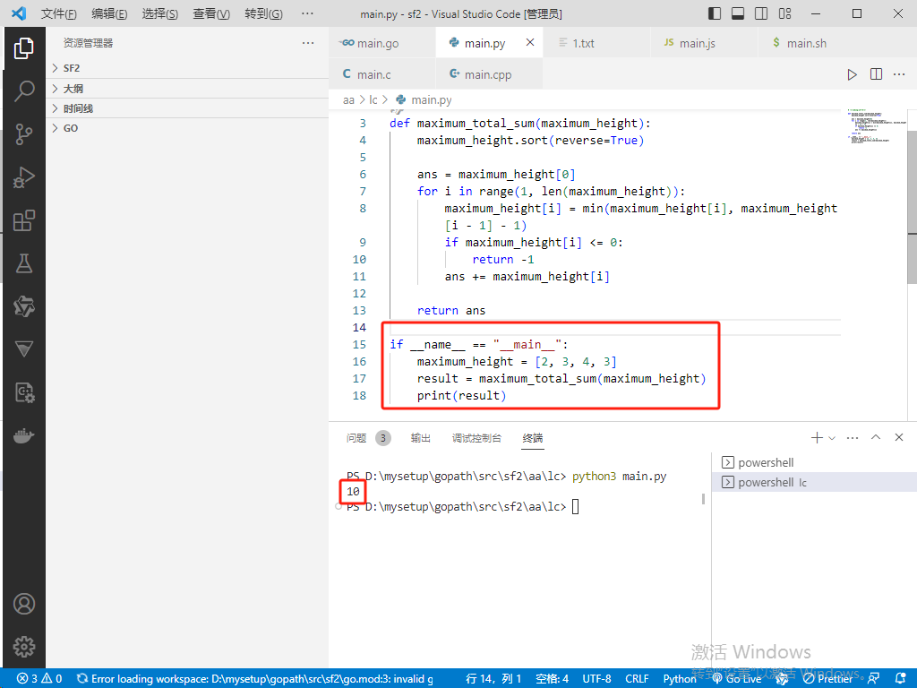

Python完整代码如下:
# -*-coding:utf-8-*-
def maximum_total_sum(maximum_height):
    maximum_height.sort(reverse=True)
    ans = maximum_height[0]
    for i in range(1, len(maximum_height)):
        maximum_height[i] = min(maximum_height[i], maximum_height[i - 1] - 1)
        if maximum_height[i] <= 0:
            return -1
        ans += maximum_height[i]
    return ans
if __name__ == "__main__":
    maximum_height = [2, 3, 4, 3]
    result = maximum_total_sum(maximum_height)
    print(result)
