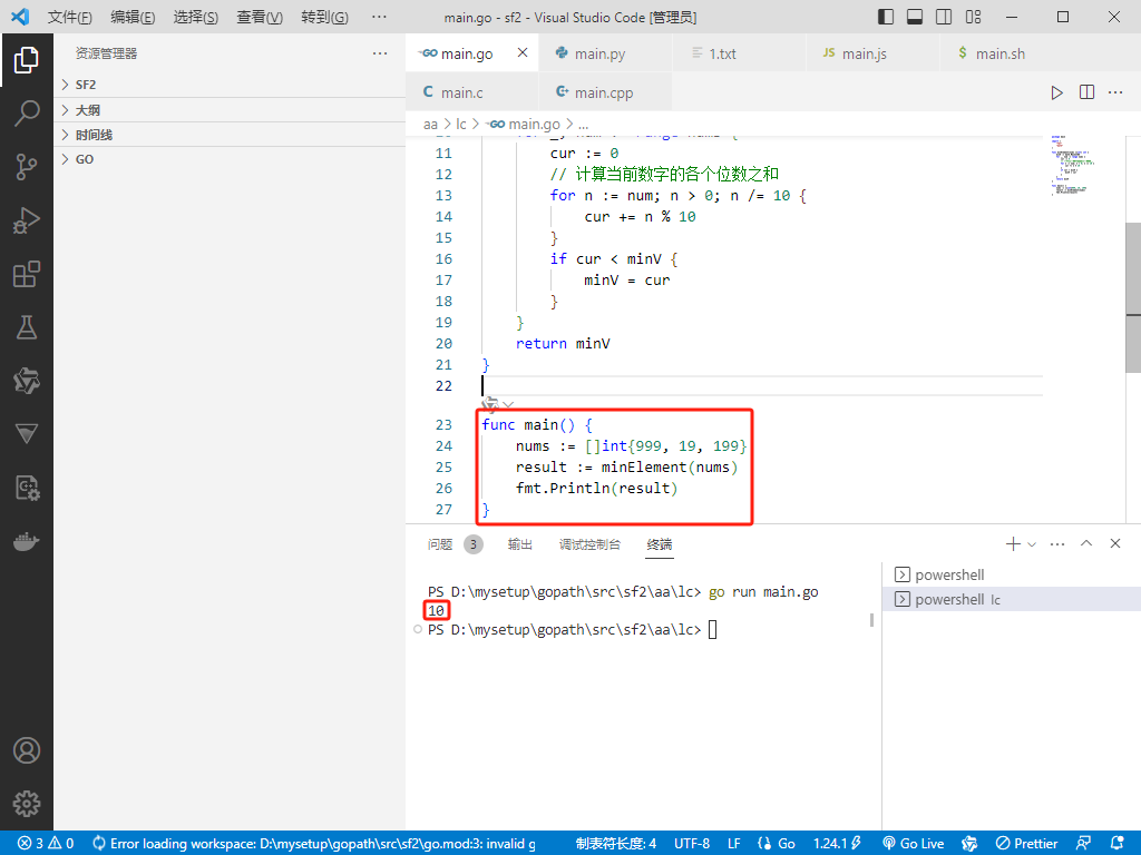

Go完整代码如下:
package main
import (
	"fmt"
	"math"
func minElement(nums []int) int {
	minV := math.MaxInt64
	for _, num := range nums {
		cur := 0
		// 计算当前数字的各个位数之和
		for n := num; n > 0; n /= 10 {
			cur += n % 10
		if cur < minV {
			minV = cur
	return minV
func main() {
	nums := []int{999, 19, 199}
	result := minElement(nums)
	fmt.Println(result)

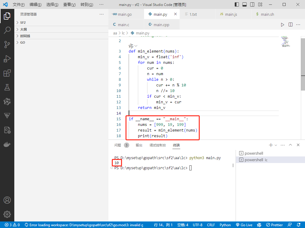

Python完整代码如下:
# -*-coding:utf-8-*-
def min_element(nums):
    min_v = float('inf')
    for num in nums:
        cur = 0
        n = num
        while n > 0:
            cur += n % 10
            n //= 10
        if cur < min_v:
            min_v = cur
    return min_v
if __name__ == "__main__":
    nums = [999, 19, 199]
    result = min_element(nums)
    print(result)
